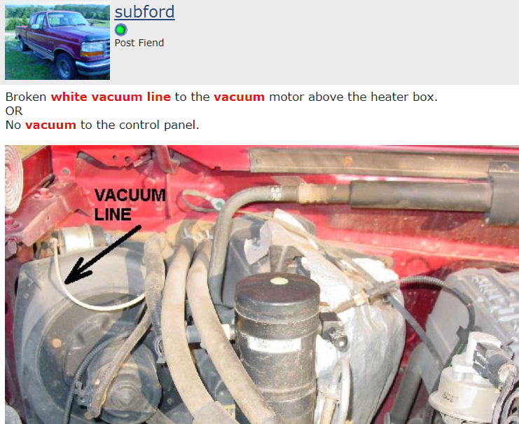

your a/c vacuum could be on pass. side vacuum line(white) going to diverter valve on top of blower motor, truck needs to be at operating temp before doing the KOEO(key on engine off) and then codes fixed, before doing KOER(key on engine run) or you get bad codes, chasing your tail.

The white vacuum line did have a crack in it and another vacuum line that came out the same way but went the opposite direction towards a t adapter closer to the engine. I replaced both with rubber hose and they worked the last time I got the truck started. How long do you think the tuck should run to be at temperature before the code tests?
