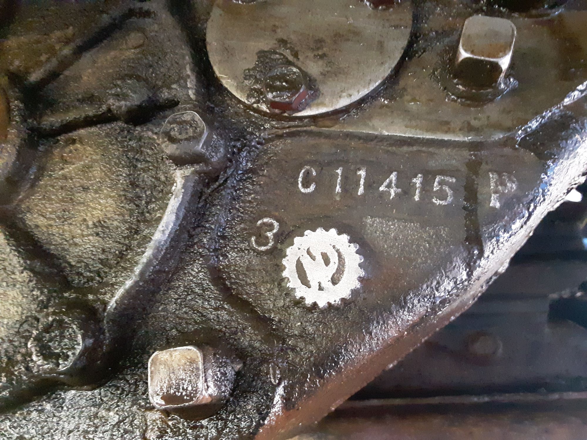

Thanks for the quick reply's. Here's some pics.

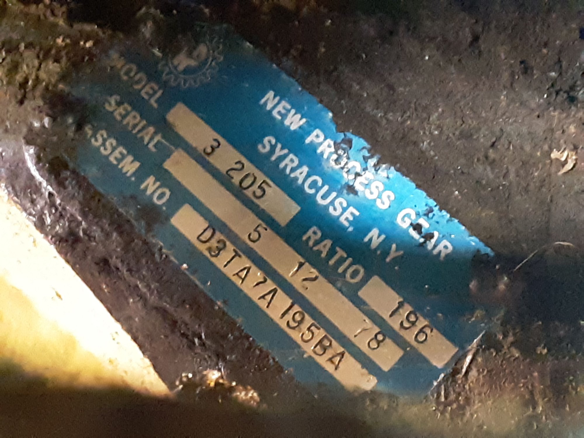

Awesome i found the tag thanks. here it is.Also, what does the "3" mean before the 205??? Also. when i look at a picture of a np205. everything is opposite? like for instance sitting under the truck looking towards the engine bay behind the transfercase the rear driveshaft is on the passenger side(to your right). pictures online show it on the left side of the rear of the transfercase.

NP205's were made for right and left side differential front axles. Square body GM's were right side.

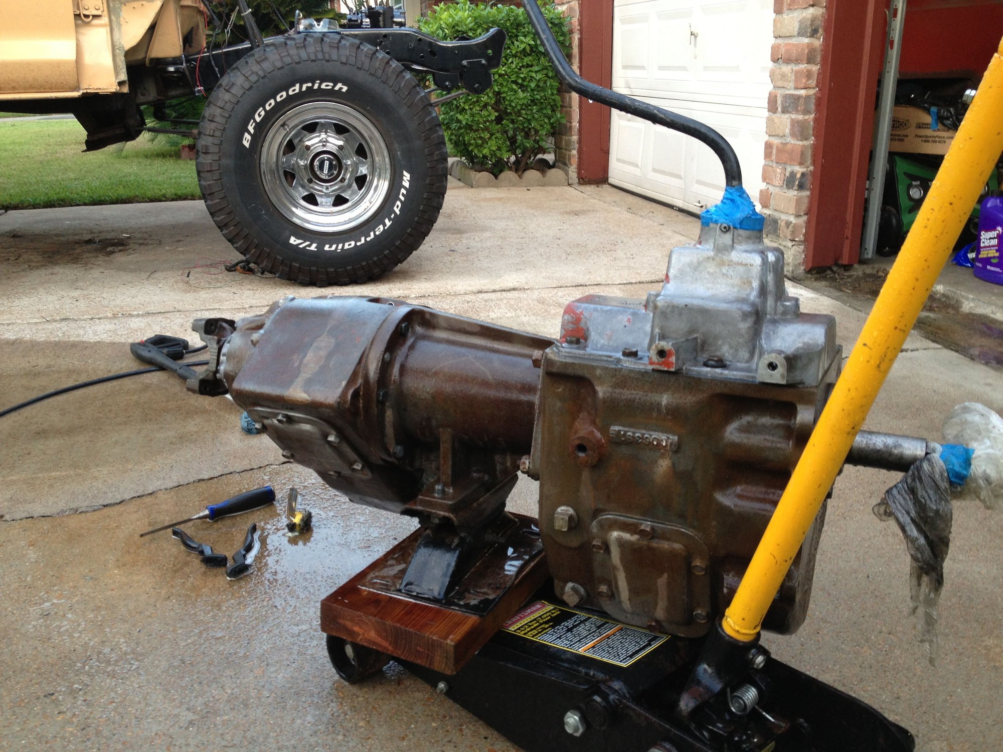

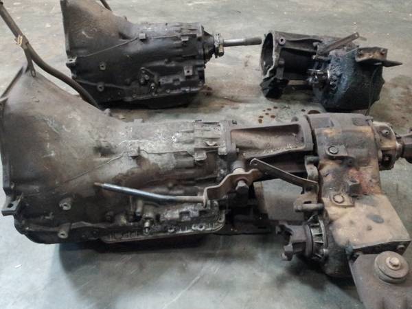

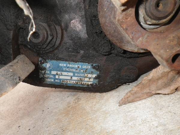

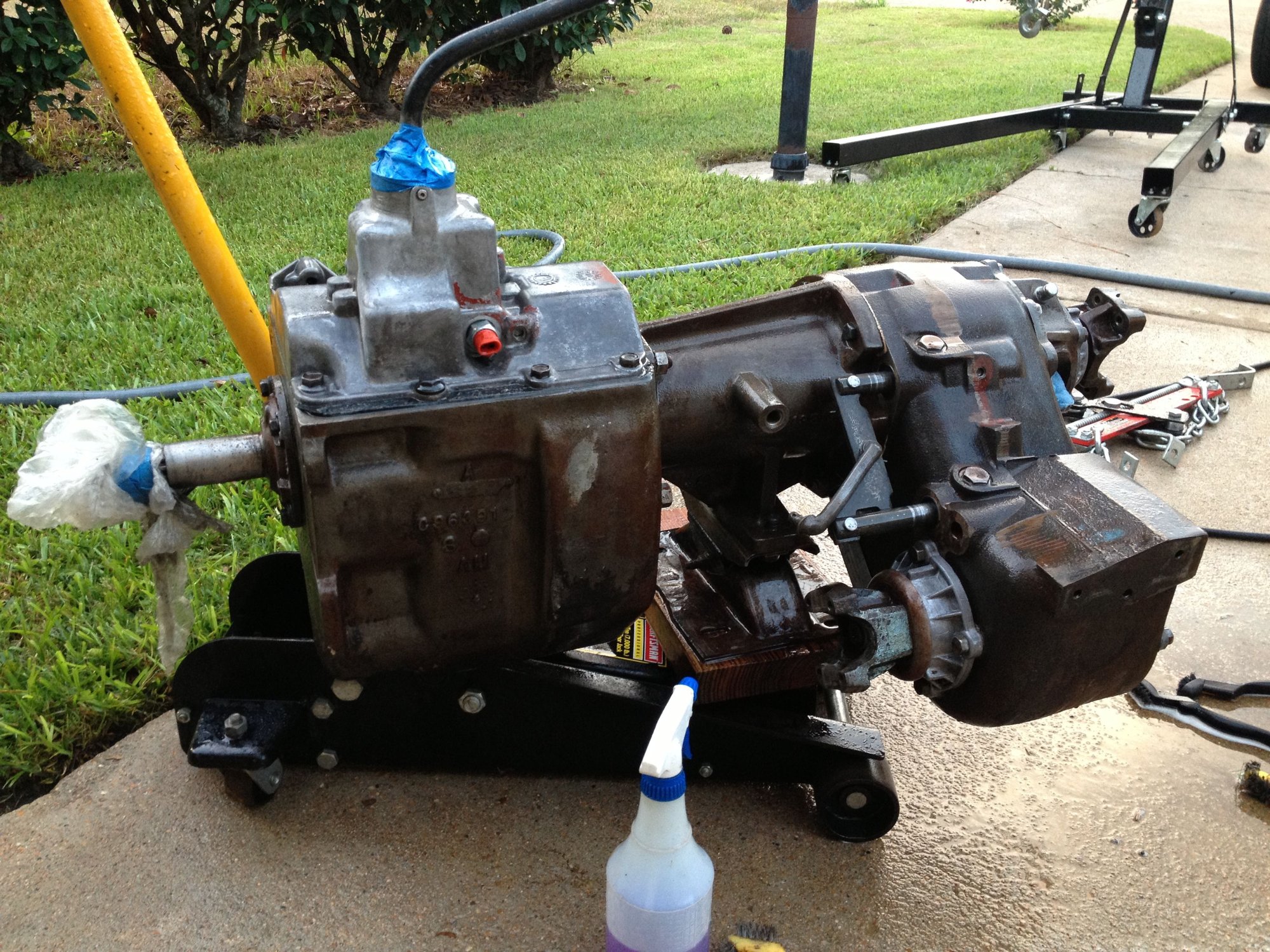

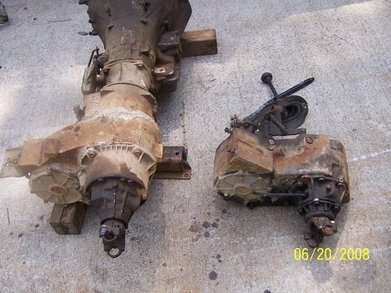

No idea on the #3. Here are some pics I have of a FORD 203/205 visual difference and a 205 with a C-6 and 435 4 spd.
205 on left, 203 on right.
203 on left, 205 on right.
NP-435 4 spd and NP-205 xfer case.
C-6 and NP-205

thanks everyone, so i'm pretty sure the 3 before the 205 means range of 3. as in 4H 4L and 2H.

You forgot Neutral....
And even though you could be correct, I thought the "range" was just the Low and High part of a transfer case. At least that's how I think of it, but that doesn't mean that's what the engineers thought about it.
