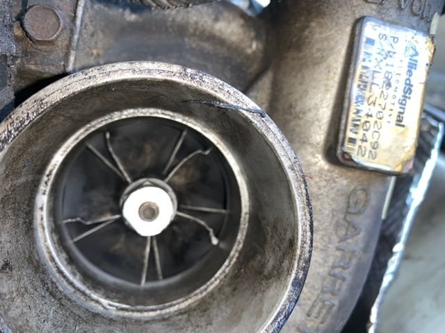

I think I may have found what the problem is. It Looks like I need a new turbo or rebuild this one with a wicked wheel.
