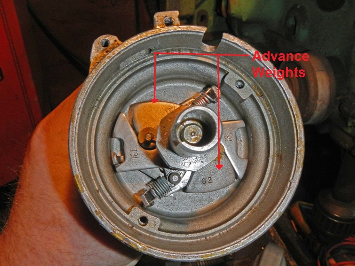

Timing is a whole other bailiwick.
There are 3 parts to the timing setting or curve.
Initial or base: This is exactly what it sounds like it is the base setting with no advance and what you set with a timing light at idle.
Mech advance and/or Total: mechanical advance it exactly that it is the amount of advance done by the advance weights in the distributor (See below pic of the mech advance in a Ford dist) as engine speed increases the mech advance advances the engine timing. Mech advance plus the base timing is the total advance. Example you have 10° base timing and 15° Mech advance for 25° total advance.
And finally, there is vacuum advance. This is the advance pulled in by the vacuum can on the dist, this advances the ignition timing under cruise conditions to increase fuel economy. Typically this is hooked to a port on the carb that goes to just above the throttle plate so it reads intake vacuum when the throttle is opened sufficiently.
If you want to know more about timing and how to set it and adjust it just say the word.
