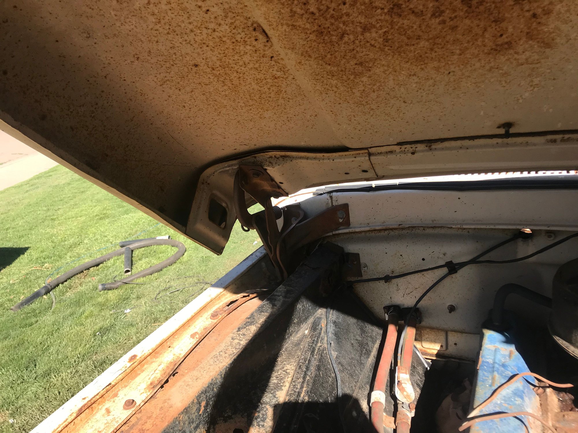

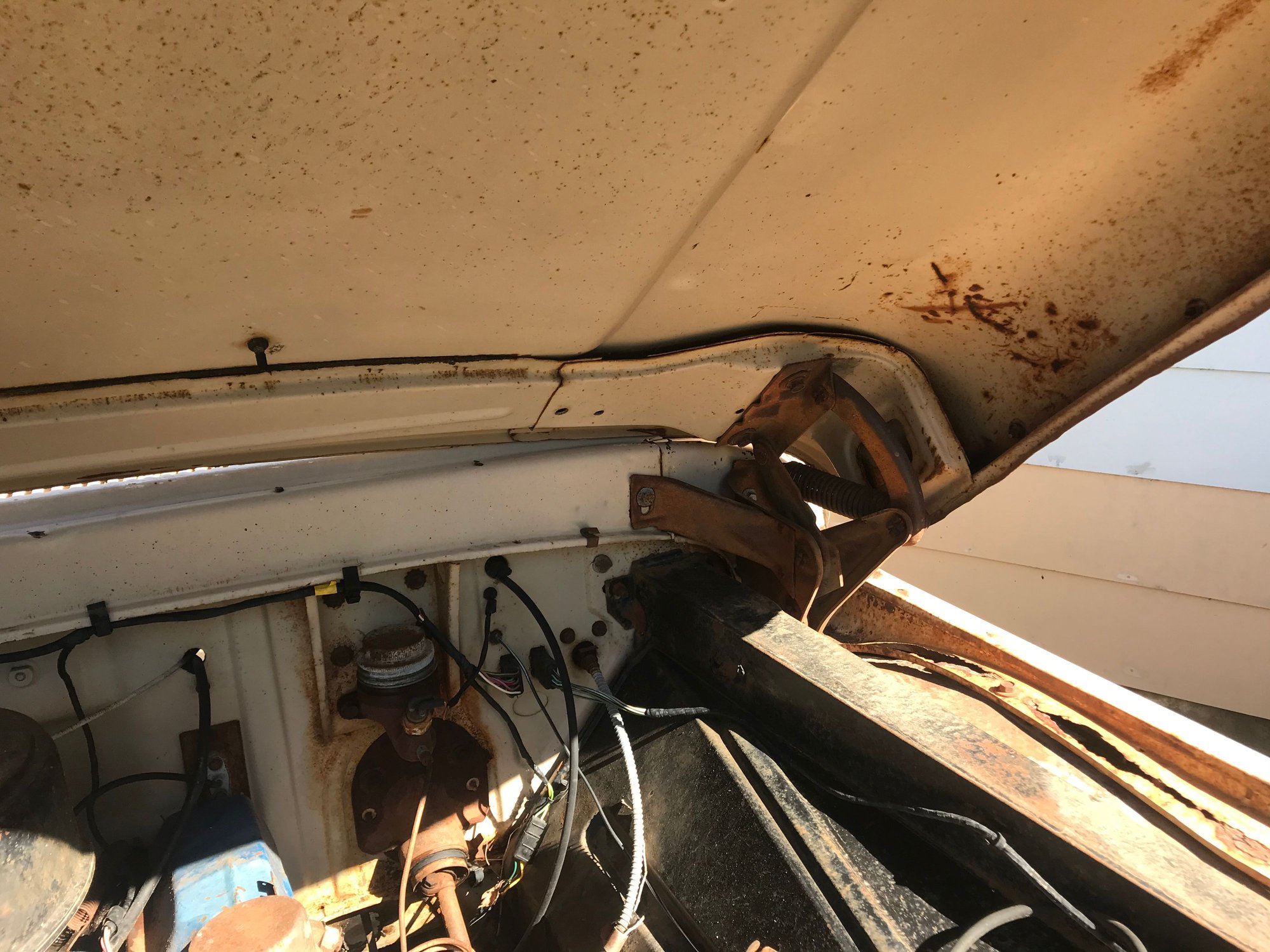

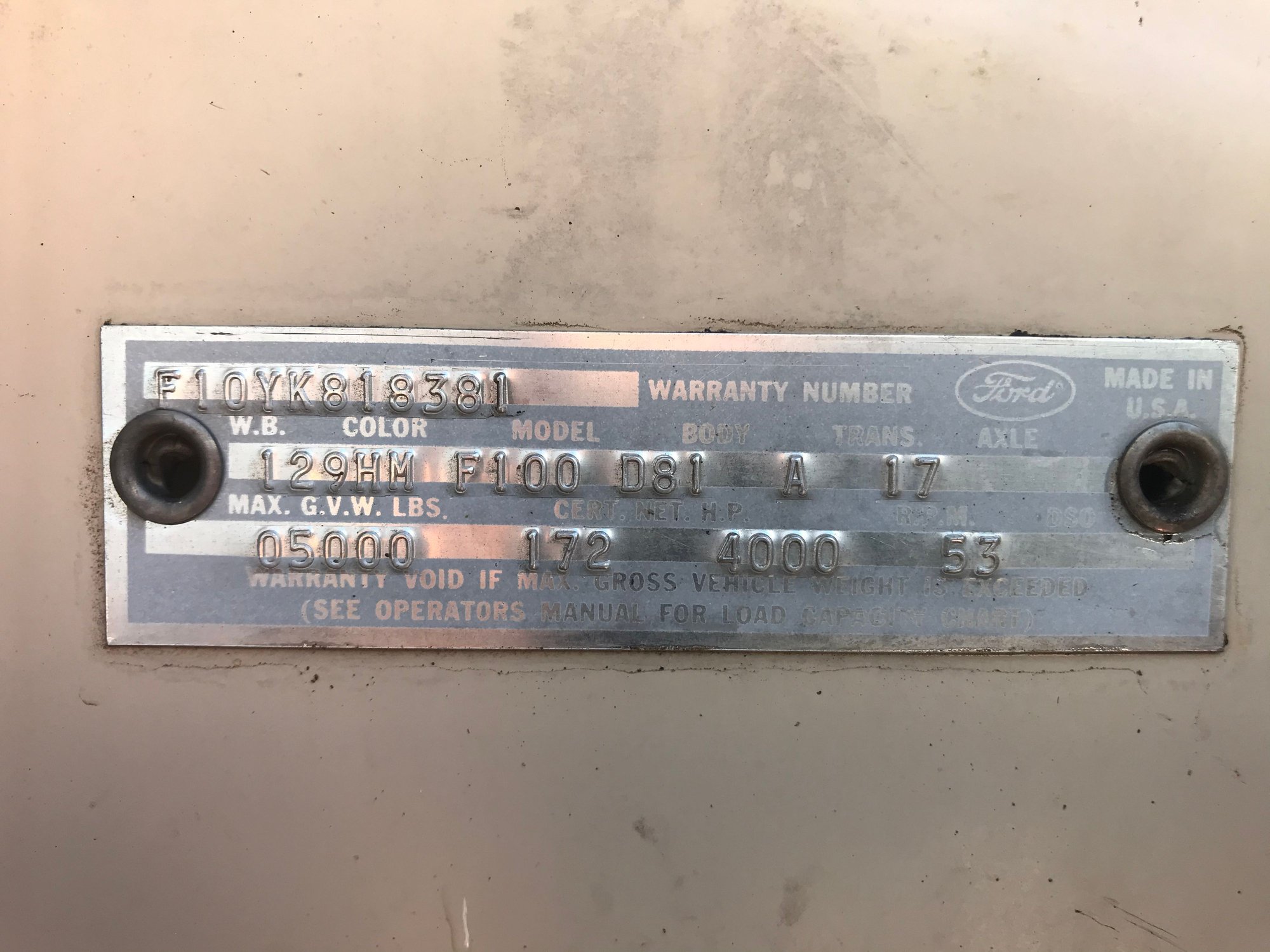

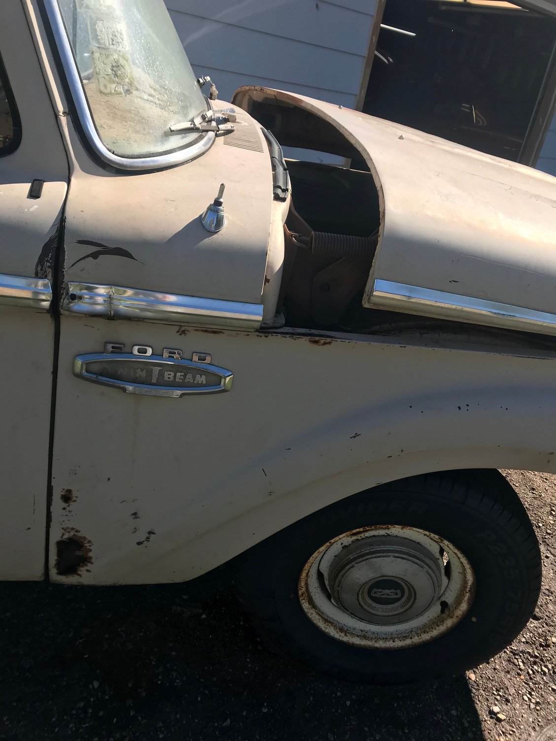

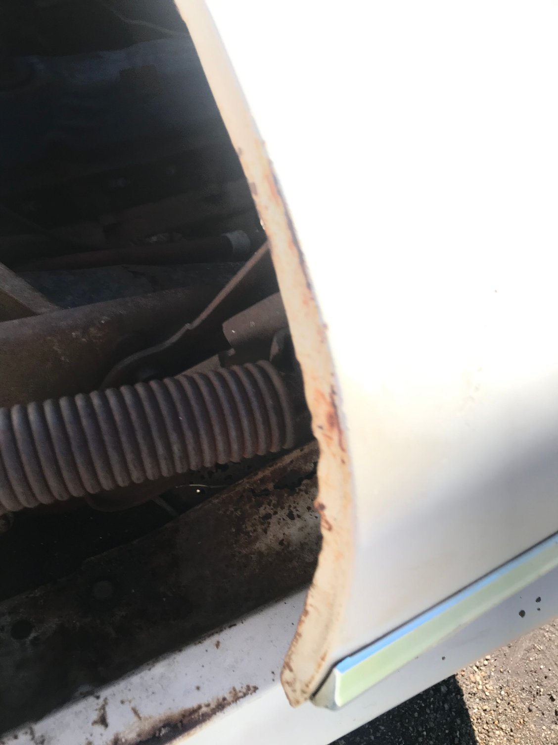

I finally got my 66 ford out of the salvage yard and it’s at home I have 2 questions can someone decide my vin and can someone tell me what’s wrong with my hood hinges they don’t look bent or anything this is the first truck I had with this problem thanks for any help

The hinges have been over-extended. Usually happens if the hinges are not lubricated and the hood is opened - forcing the hinges to open without regard for the binding. Usually time for new hinges. Here's the full decode.
F10 - F100 4x2
Y - 352 2V 8 cylinder
K - Kansas City, MO assembly plant
818381 - 1966 - Assembled February 1966
129" Wheelbase.
HM - Sahara Beige and Wimbledon White
F100 - F100 4x2 5,000 Lbs GVWR
D81 - A = Medium beige crush vinyl and medium beige cody pattern woven plastic - 81 = 81B = Custom Cab
A - New Process 435 4-speed standard transmission
17 - Ford 9" 3.25 (3.3M) WDM-H-S
5,000 lbs. Gross Vehicle Weight Rating.
172 net HP @ 4,000 RPM
53 - Kansas City, KS Sales Office

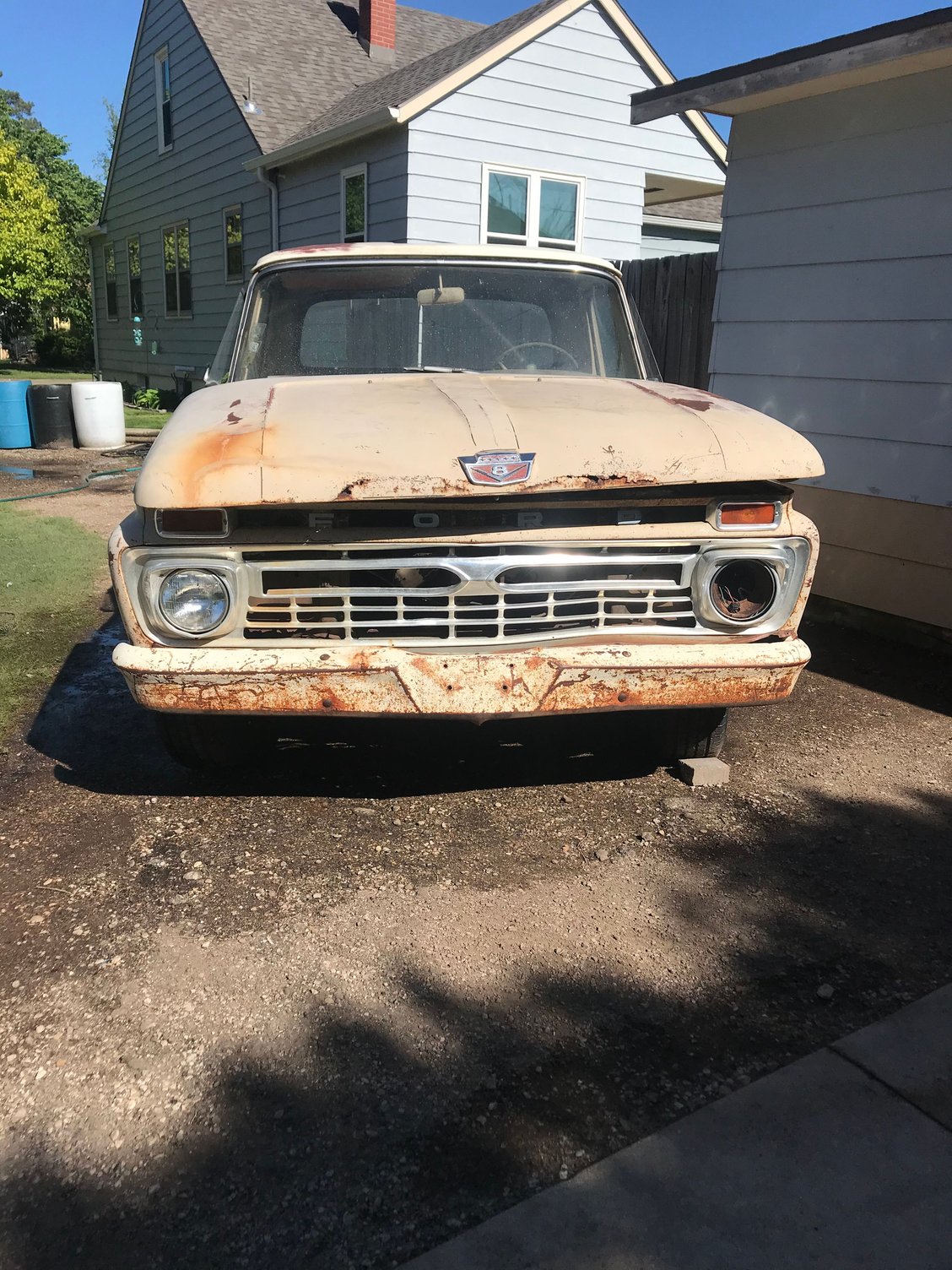

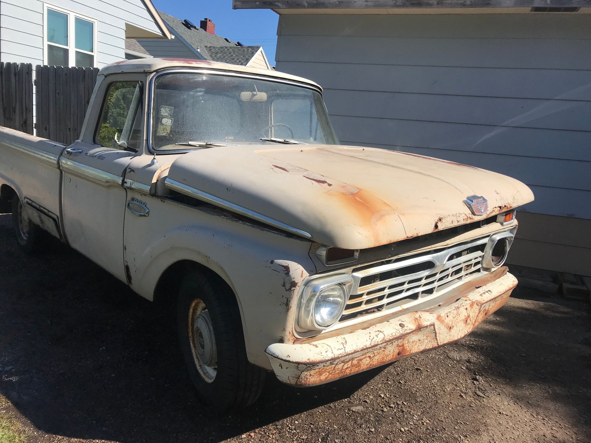

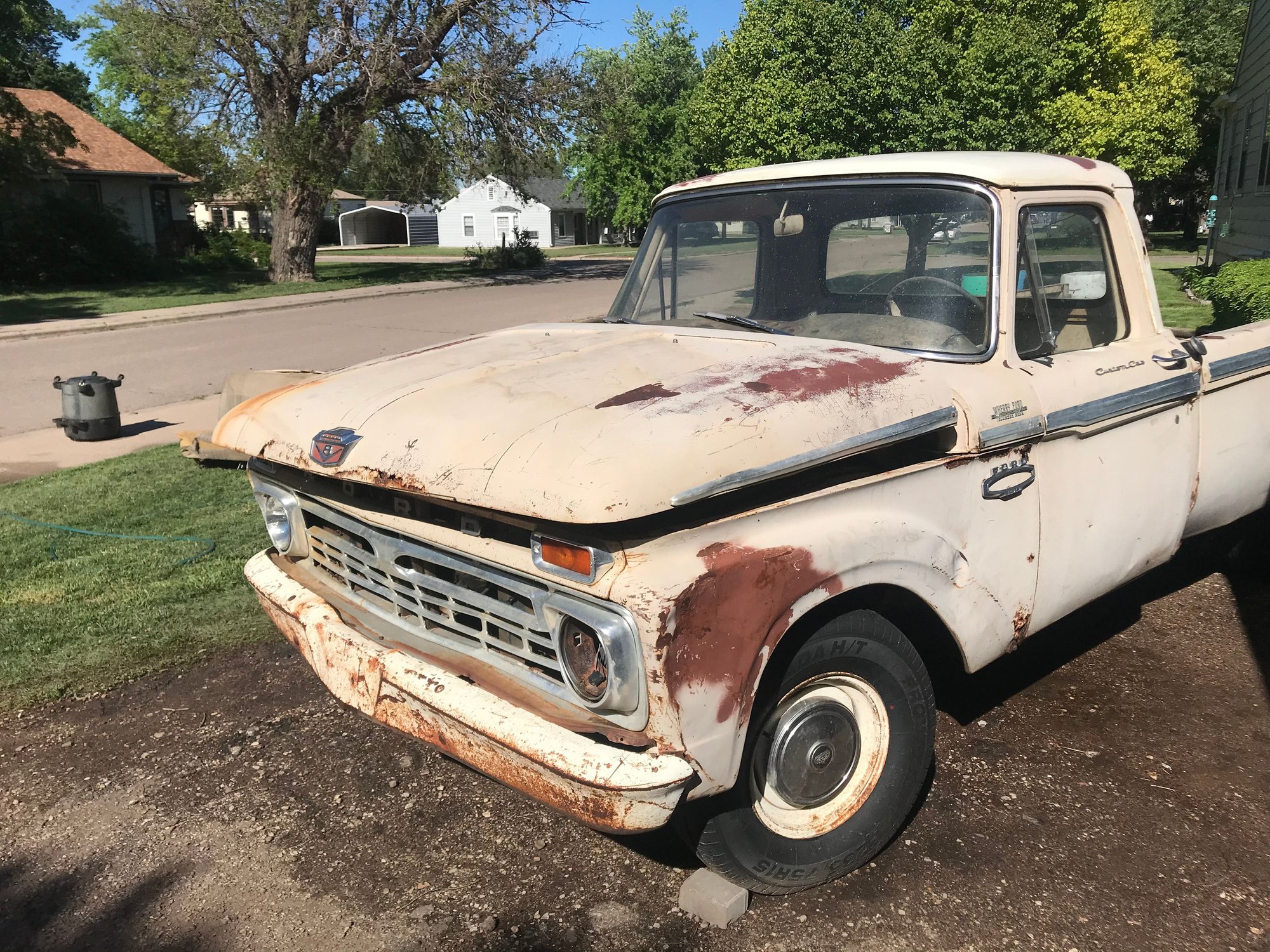

Looks like you have quite the rust repair project coming up. Good luck with that. I've seen worse.
