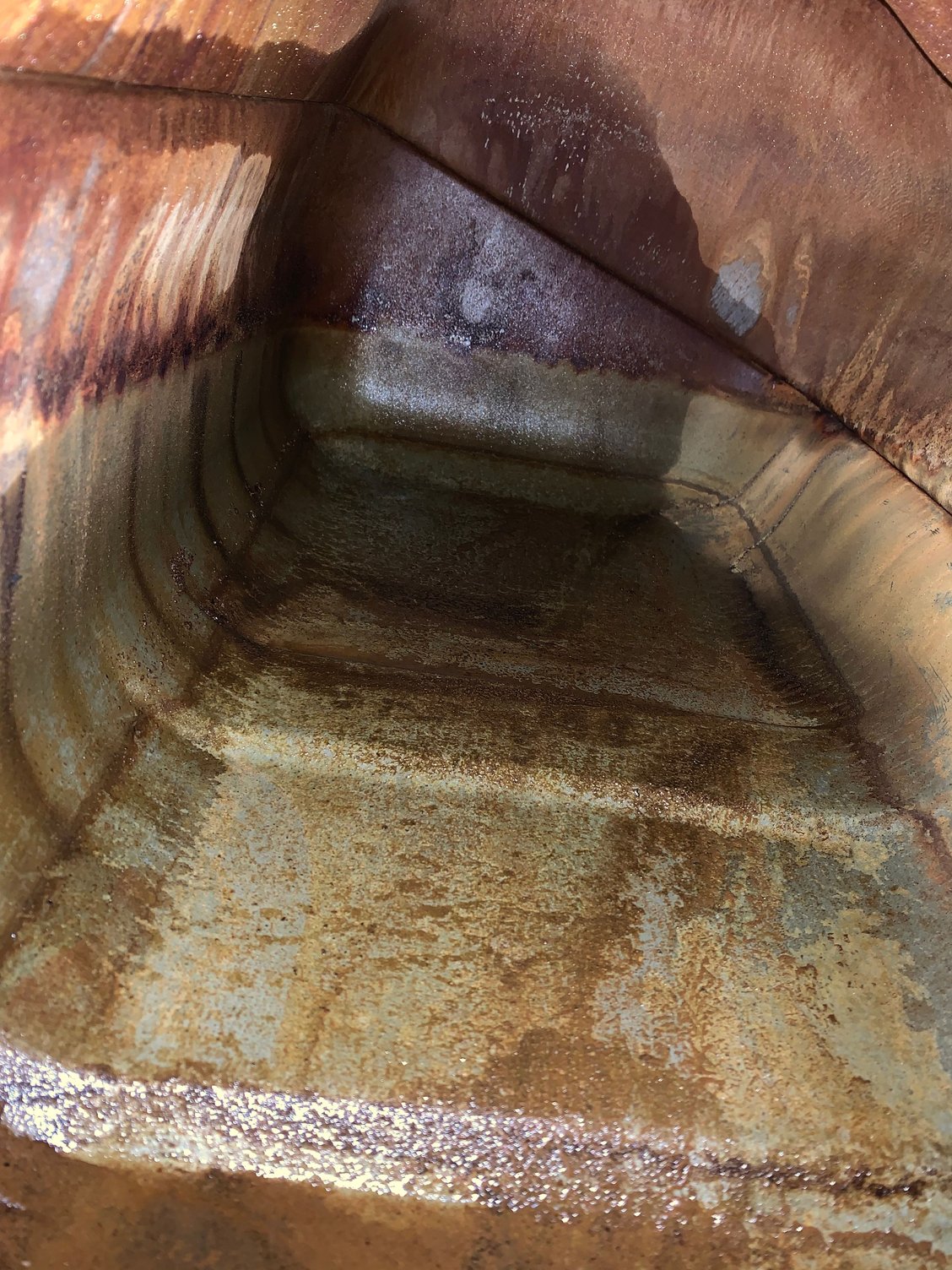

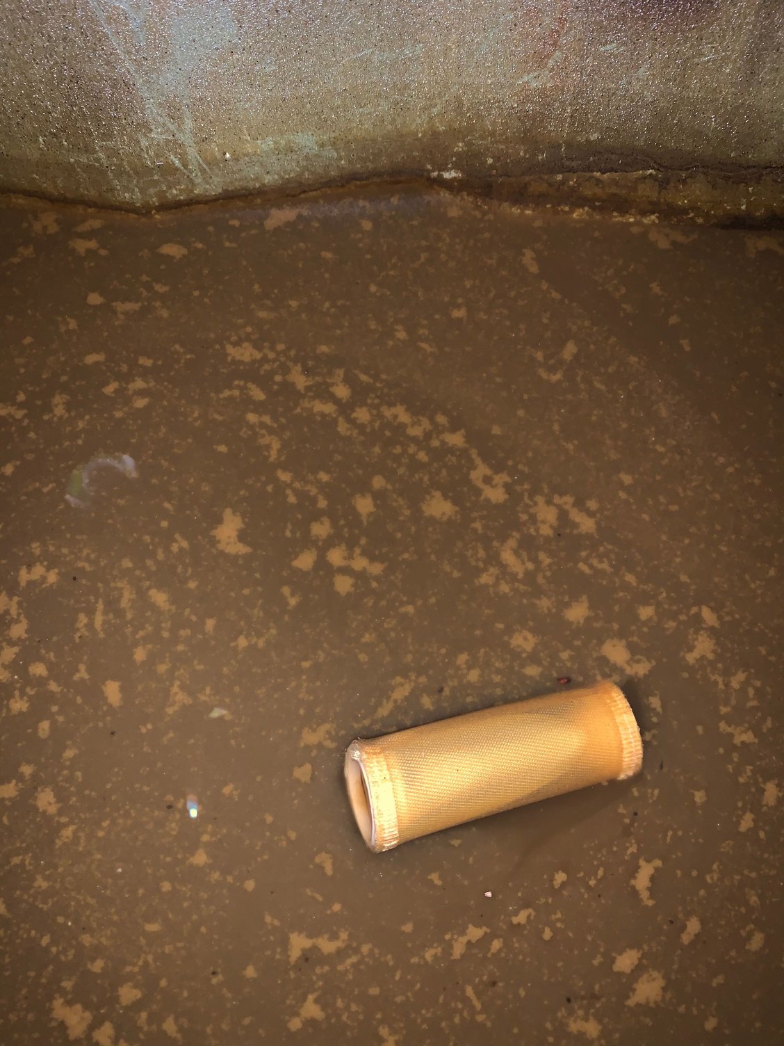

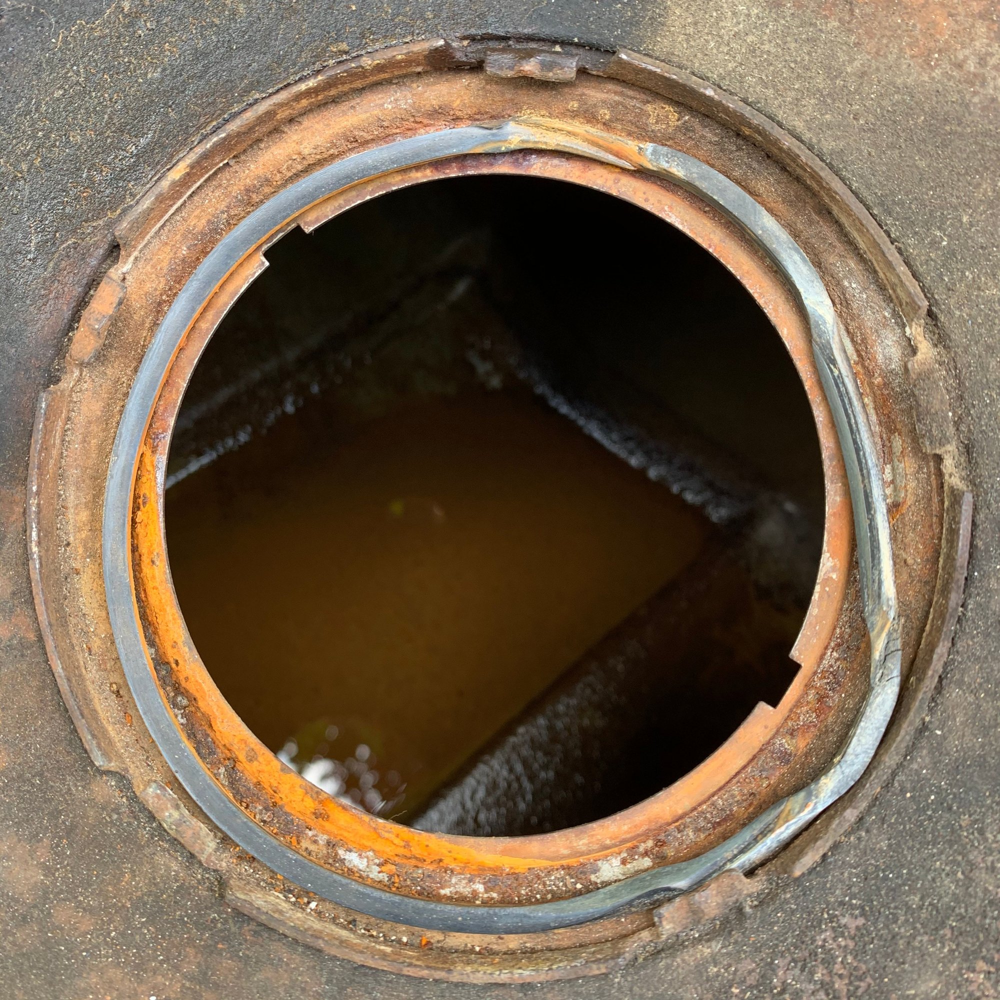

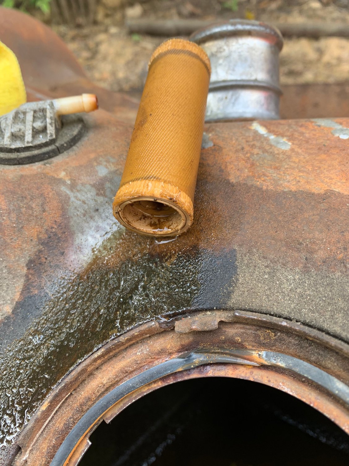

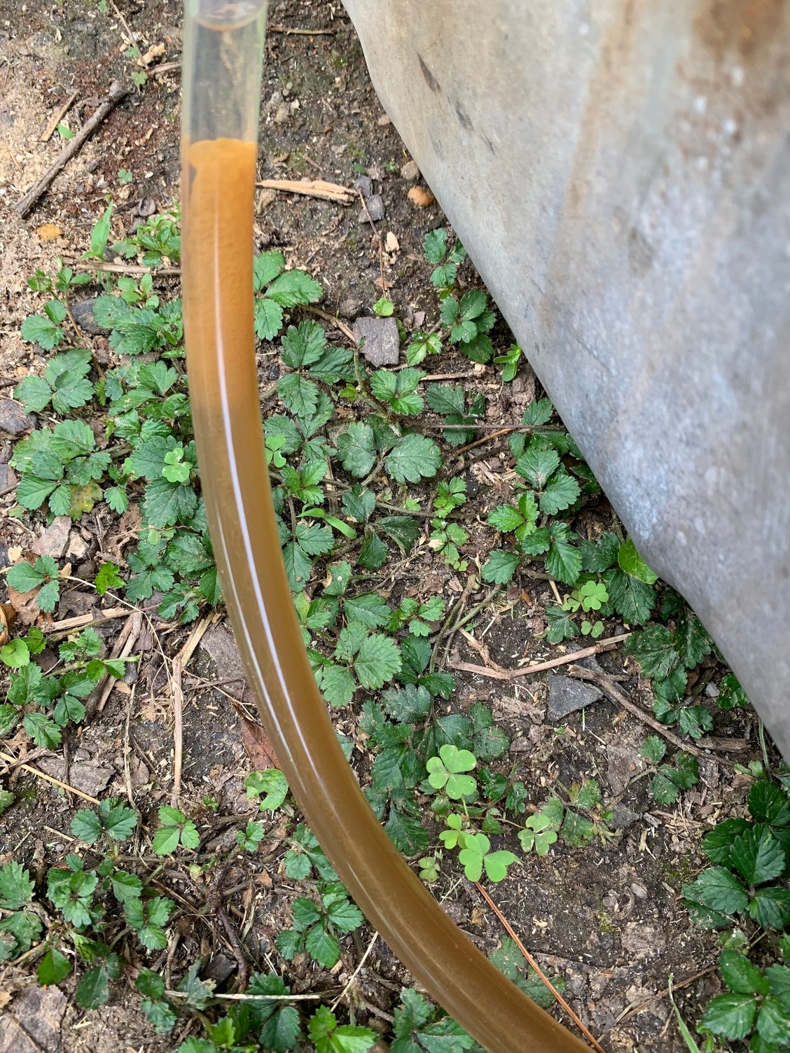

After dropping it, I noticed:
•a buggered o ring on the sending unit
•the sending unit filter fell off and was floating around in the tank
•more brown water mixed in with fuel
•lots or crappy rusty areas in there
pictures are below
I’m assuming NOW it’s best if I bite the bullet and get a totally new sending unit, o ring, vapor seal, etc.
anything else you’d recommend I pick up?
it’s my first time dropping a tank, any advice is appreciated.
thanks,
JT

UGH!!! Yes....new tank... Now, I have an '84, 6.9idi, I went with the tank for an '85...cannot source sending units for an 84, they are 2 inches...so, go for the newer style...3.5 inch opening for the unit. Rear units are not available yet...hope to see them by June/July so I can R+R my rear tank. Tank, sending unit, new showerhead, roll-over valve and grommet, and pigtail from LMC parts because the connectors are a bit different between 84 and 85. Of course, you could get a 2 inch tank, and send your sending unit to tri states radiator in NY for a rebuild. Good luck...

I didnt think the tank looked bad. I'd remove the rust with electrolysis and then just rinse it well. Seams all looked good.

As slick as the electrolysis process can be (I've used it on heavier cast iron projects), it's time to scrap that tank. The tank has some kind of internal coating (tin? zinc?) and that has been seriously breached. Plus, the thin base metal has severely eroded away in many places. Sure, you can remove the rust, but that shiny metal underneath has zero protection against a recurrence, and is already dangerously thin in places. It's just asking for trouble. The risk/reward ratio just doesn't work, especially with only $85 for a replacement.
Now, I will say the electrolysis process works wonders. I've cleaned up heavy material and had it looking like new, but that was thick cast iron stuff. Pits that were .040" deep were no big deal on inch thick cast iron. It's a different story on .050" sheet metal. (Just guessing on the thickness of the tank sheet metal.)
