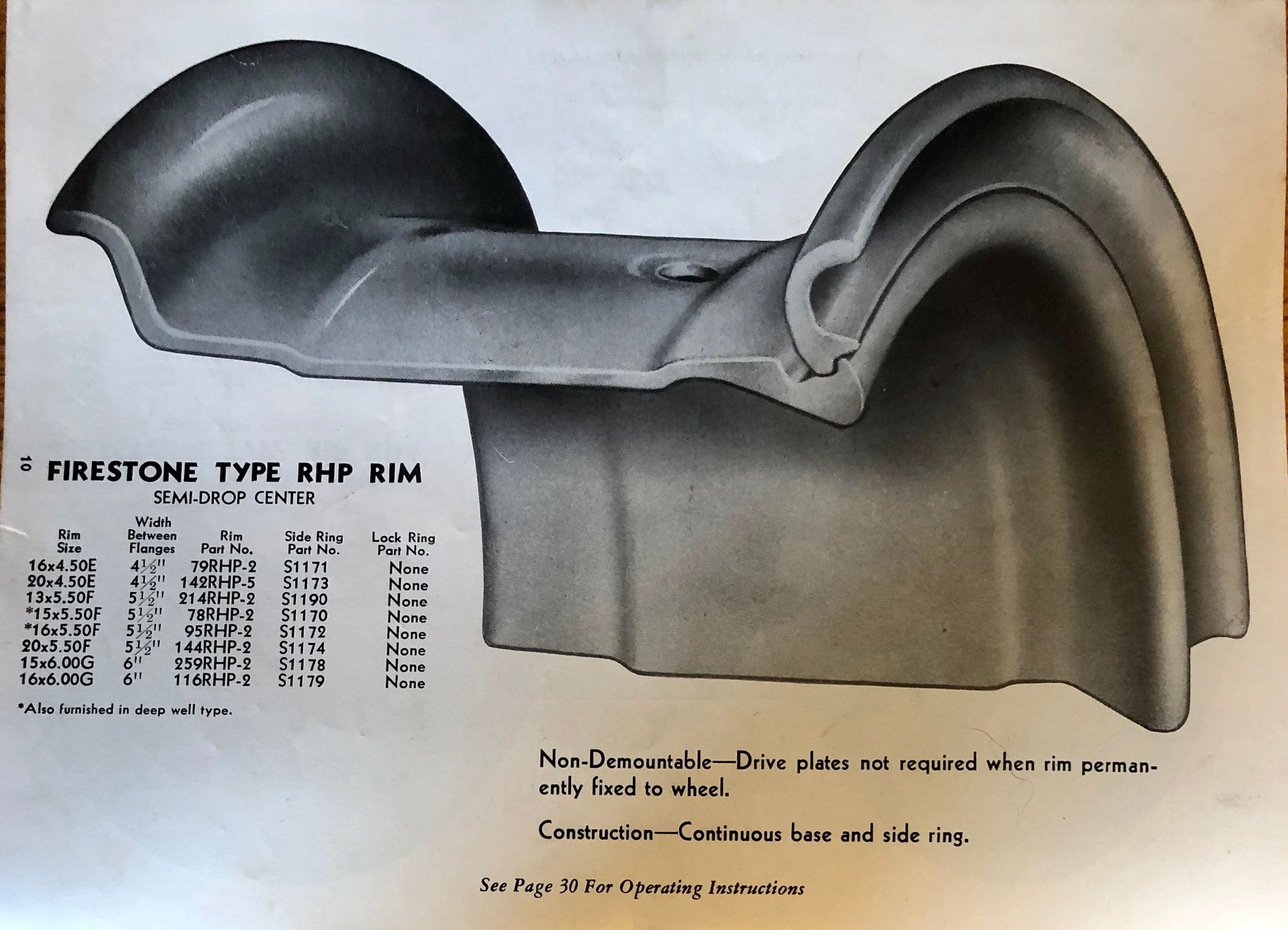

Saw these offered for free locally, cannot recognize the safer ones, but I believe the wheel covers are Ford? Maybe someone can use these?

Look like F-250 16” x 5.5” stock two piece wheels having the Firestone RHP continuous/unbroken rings. Might be hard to find a shop to service them in CA, it’s getting hard here too, but they are safe to use if unhurt by rust, etc. The guy is no doubt giving them away to save himself the cost of recycling. Stu

Yeah, all these are 5.50F width. The F is the design of the semi-drop center. Stu
