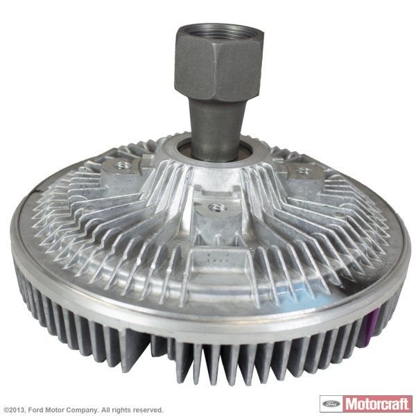

Put a manifold gauge set on it and monitor the system pressures. When you see the high side rise above 350 spray some water into the front of the condenser to see how far the high side falls. Your problem is probably lack of airflow through the condenser. You don't have a bug screen in front of it do you ? The fins in good shape ? Then I would be looking at the fan and fan clutch (righty tighty, lefty loosy...). You should see 35-45 psi on the low side and 250-350 on the high side at 1500 rpm.
