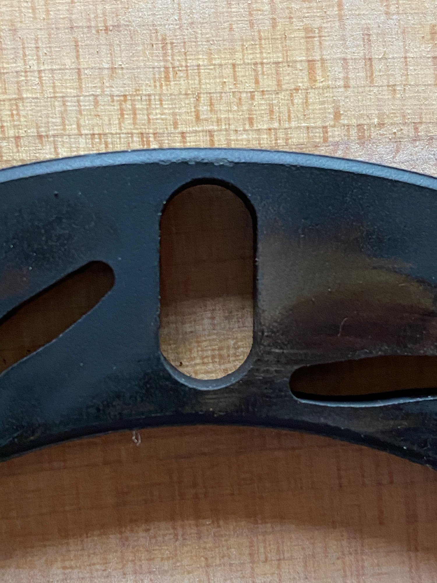

2,000 engine hours. 120k miles. P0299 Code, so I pulled the turbo for cleaning. Vanes look great, but unison ring frozen to housing hub. I'm cleaning everything up before reassembly, but I'm wondering about the slits in the unison ring. Are they supposed to be perfect ovals or are they supposed to be wider on the ends of the slit and narrower in the center (see photo).

that looks good to me

Check for wear in the actuator hole, if any, replace it.

Looks good to me as well. Clean it up and reuse.

@jswartz84
There is wear in actuator hole on the back side. It is ovalized for the depth of that pin.

I think that it looks good. You have a lot of miles left on that one.

Mine did too. I was advised to replace it by the fleet mechanic at my work. I should have to turbo back in this weekend, we'll see if it gets rid of the studder under heavy load.

Flip it over? I know that sounds like a farmer solution, but... I'm guessing mine ovalized because the actuator pin was working hard to rotate the frozen unison ring. So... if I flip it over so the pin has a nice round hole rather than a worn hole, that should work for another 80k, right?
My assumption is that by 200k miles, something else will fail (oil cooler, EGR cooler, HPOP, etc) which will require pulling the turbo again in few years. I could inspect the unison ring again at that time.
If I replace the unison ring, where do you recommend that I source a quality replacement part?

additional photos of actuator hole in unison ring
First photo is the front side (away from actuator).
Second photo is back side (against actuator pin).
You can see a slight ovalaization of the hole to the depth of the actuator pin. I was thinking about cleaning-off the burr and flipping it over.

Wont fit flipped over

Ha. Thanks. Clearly I haven't cleaned it up and tried anything yet.
You think that wear pattern at the hole is bad enough to warrant replacing?

That's just what mine looked like. After I get the turbo back in, I'll let you know if it cures my surging under load.
I picked up the unison ring on ebay (motorcraft) for $50 so if doesn't cure it, I'm not out much.
