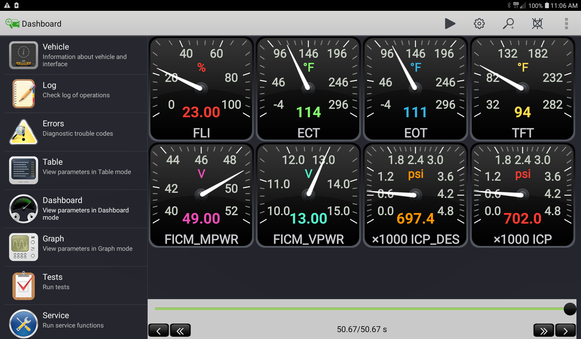

I went out and grabbed a screenshot of a cold start. The FICM took about 30 seconds to climb to 13V, ICP jumped up right away. Still white smoke coming out but didn't know if anyone saw anything of interest I don't know about.
Also noticed a Turbocharge code P0299-60 what is that? Thanks for all the help

The supply voltage to the FICM took about 30 seconds to build, not the FICM. These is typical of the 110a alternator, which means you need to keep on top of the batteries and exchange them as the start to get weak. Due to your funds situation, I would get an overdrive pulley for the alternator, which you can do for under $15. As you have more funds you can upsize the alternator to better protect the FICM. However, IMO its the batteries that put the FICM at the most risk, too much attention paid to the alternators.
P0299 - turbo underboost.
