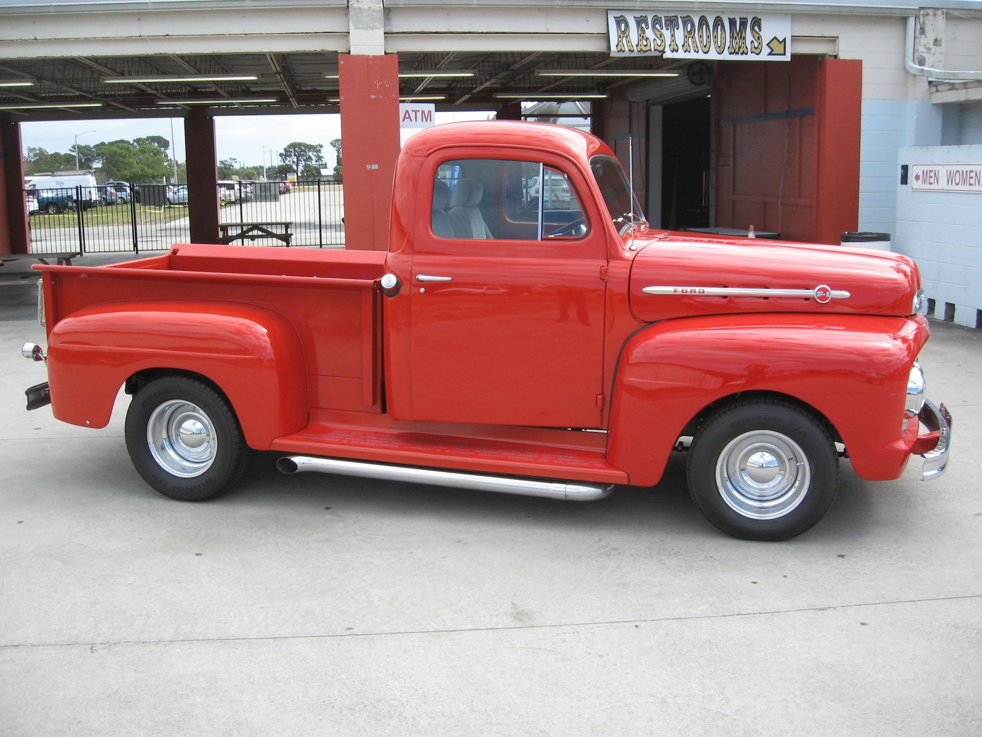

Old May 11, 2020 | 06:52 PM
crt1137's Avatar
crt1137
Joined: May 2020
Posts: 2
That’s my baby 1955
1956_F100's Avatar
1956_F100
Joined: Apr 2016
Posts: 645
Likes: 10
I'm fairly certain you'll have to have an exhaust system made. I'm in the same situation but with a 390 and Ford cast iron exhaust manifolds from a 406 that are shaped like a mid-length header.
If you can do some welding there are those builder kits. I'm probably going to go that route.
Are those tilt front end hinges poking out of the valance in your picture. Mine had that back in the 1980's. I went back to the stock hood setup. It took some effort to go back, but it's just my personal preference.
