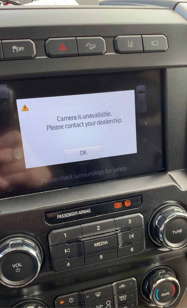

FWIW, the tailgate backup camera failed on my 2020 F350 today - purchased 4/2 with only 340 miles so far. Put it in reverse and the camera video was blank, then "Camera is unavailable. Please contact your dealer." was displayed on the screen. I'm taking it in to the dealer tomorrow to be checked out...

So, my tailgate/backup camera, which wasn't working yesterday, seemed to be working fine this morning. However, the CHMSL bed camera is now failing intermittently. I dropped it off at the dealer this morning, so hopefully they can reproduce the problem at some point. Seems like a wiring issue since both cameras are having problems (assuming they are on the same circuit).

The dealer is replacing both cameras. Unfortunately, they are back ordered until the end of the month. At least they were able to reproduce the problem...

Yes, this is exactly the behavior that I was experiencing. The bed camera was more intermittent than the tailgate camera, but both showed the same symptoms. The tech went through a fairly detailed set of troubleshooting steps on both cameras that ended with a reccomendation that they be replaced. I was told not to expect them before the end of the month.
