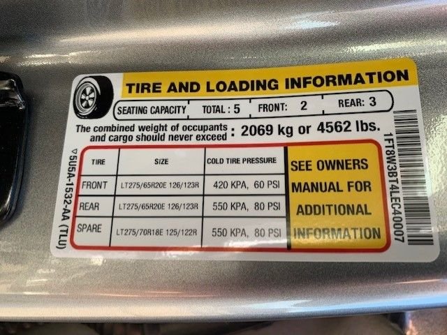

This is why I now have an F350 srw.
That's a nice payload for a SRW 6.7. 2020's new 12,400 GVWR really helped!
I still think that Ford has misprinted that truck configuration’s label at the factory, but, even allowing for a couple of hundred pounds of options, it’s still an excellent spec!
