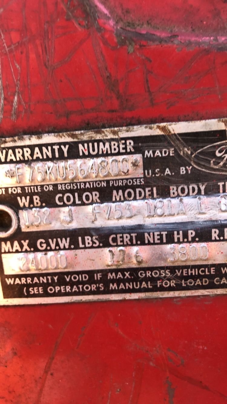

i have a 64 f750 and can’t decode it the vin reads f75ku564800

Can you take a picture of the tag, I can't seem to find a K-code engine anywhere near a '64 truck. And a picture of the truck. Maybe you're running on Bad information.

In 1964/65 the K engine code is 361 cubic inch V-8 with 2 barrel. FT engine. Built at the Louisville, KY truck plant.
I can decode the rest but no time right now.
