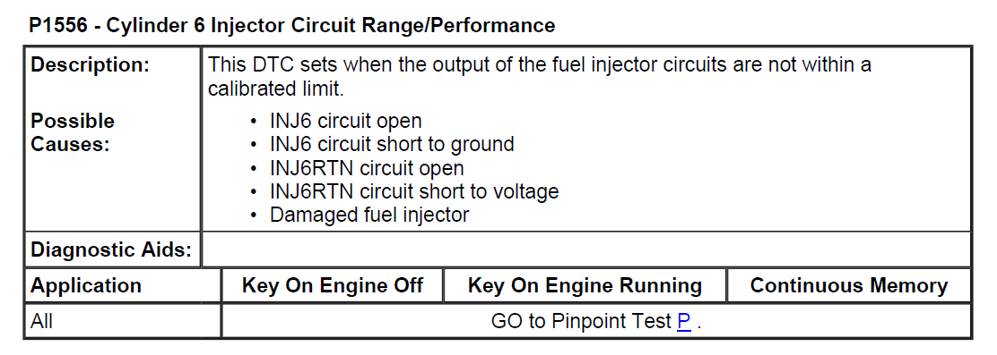

I have a 2013 F350 with the 6.7 Power Stroke. It has a
P1556 - Cylinder 6 Injector Circuit Range/Performance
error. I found this interpretation on another thread here. Thank
You!! Can anyone explain what this means in plain english? How critical is it to get it fixed? The truck has just under 12,000 miles, and a similar repair on #5 was made last year.
