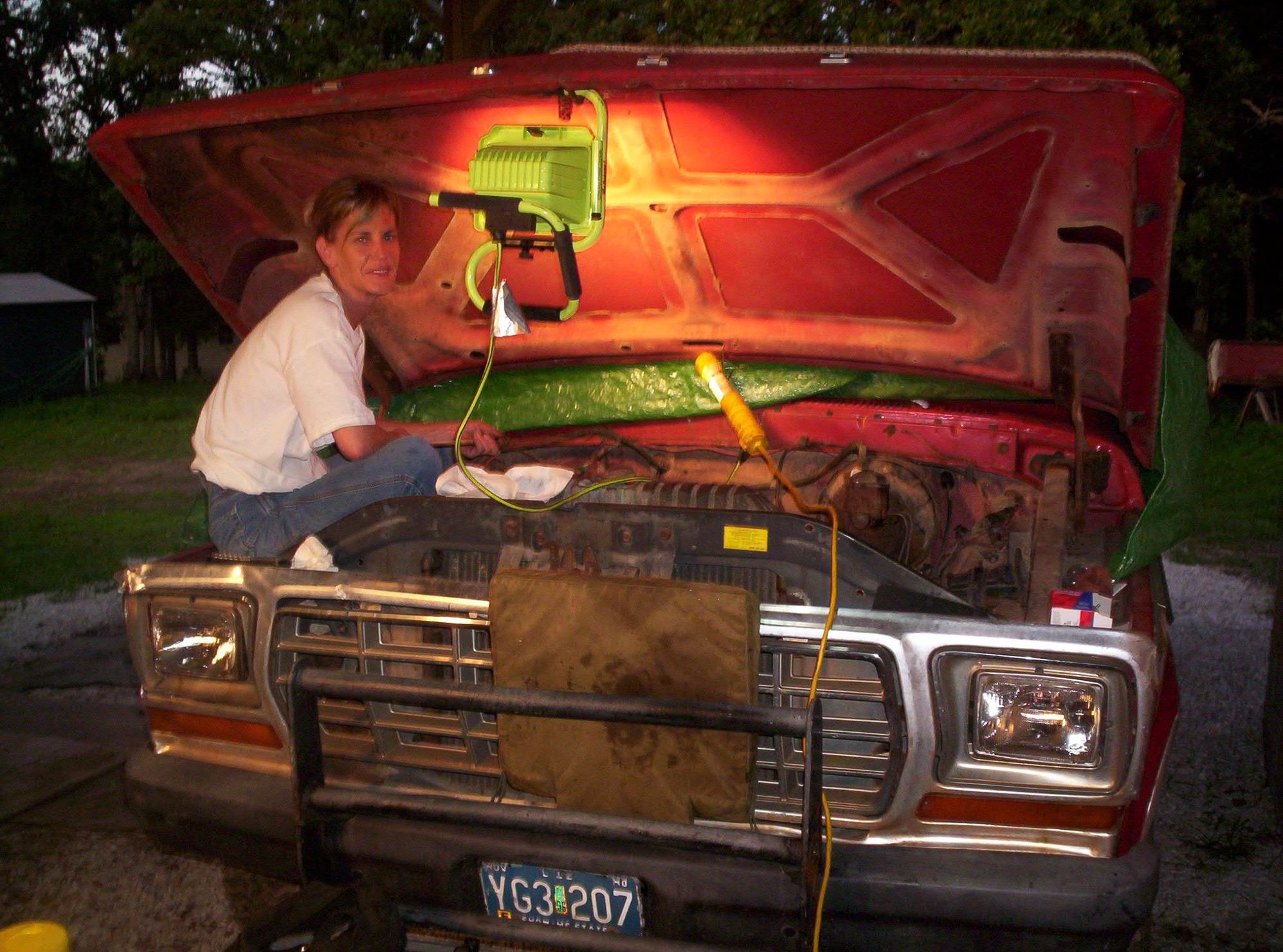

My lovely wife helping with lifter removal.

Kudo's for getting the Family involved, especially your Wife! Don't see that too often. Looks like you have plenty of space to work in too. What are those green magnetic things on the underside of the hood?

Thanks! It has been a good learning experience for everyone so far, and fun. That is a rechargeable underhood light, pretty handy and nice not to have a cord hanging down.

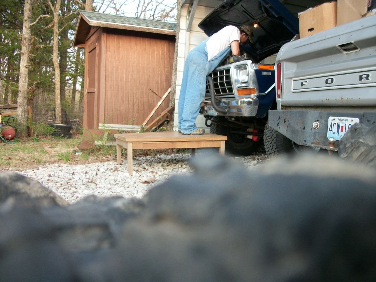

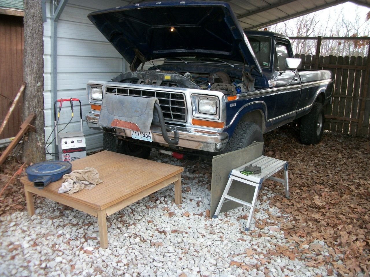

Awesome to have the whole family involved. A side note for safety/comfort. That HB bench will flip over in a blink of an eye. Build something like this to make the under the hood work safer and more comfortable/easier on the ol back. An old saddle pad makes for a great radiator leaning on pad.
I know what you mean! I’ve been thinking of doing a 3 piece box set that I can put around the front and sides or stack like you did on those framed up ones. Seems like it would be nice especially for my newer truck and boat.

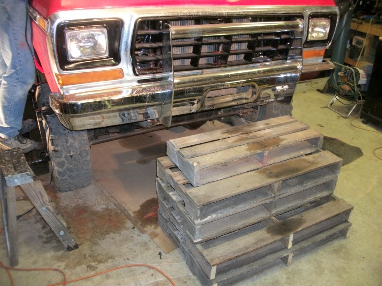

And with that nice cement shop floor you can use low profile lockable casters. I just cut down and screwed together some pallets for the front or side ones.
