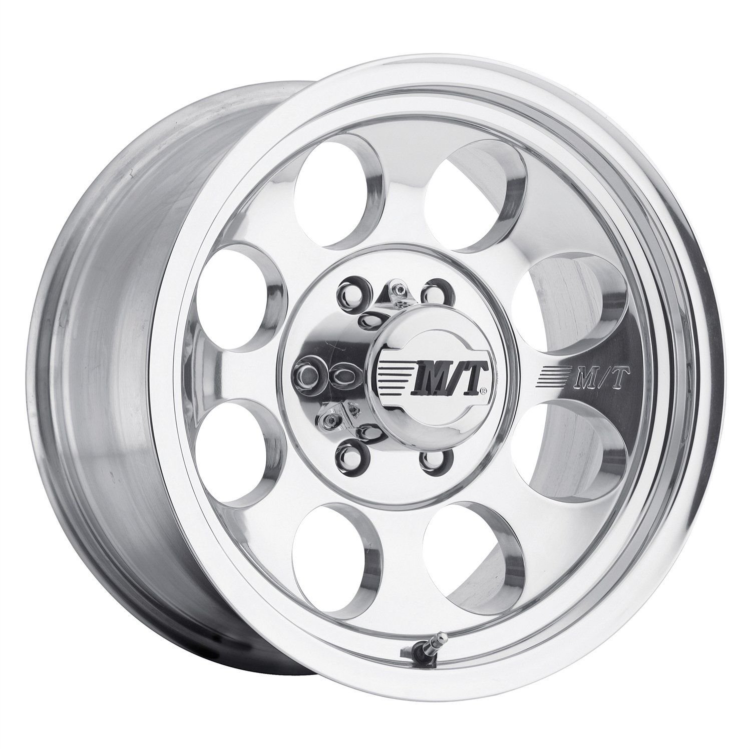

I have a 95 F150 (302) and am currently looking for wheels. I’m going to put a 4” lift in so I’m looking at putting 33” tires on as well. I am, however, having a hard time finding wheels for the truck. I’ve attached a photo of the style of wheel I’m after. If anyone has recommendations on where to buy from, that would be awesome. I am located in BC so closer the better. Thanks.

American Racing 172 Baja is available in 17"x9" to fit an F150. Part number: AR1727985
You would use a 285/70R17 to achieve 33x11.50. A 305/65R17 will get you 33x 12.50 but fewer good options and the price goes way up

That’s a Mickey Thompson Classic III. What size do you want: 15 x 8; 15 x 10; 15 x 12; 16 x 8 or 17 x 9 are all available in a 5 on 5 1/2 bolt pattern. My FSB has a 6” lift with 15 x 10 wheels and 35 x 12.50 tires.
33” is about as big as you can go with a 4” lift

I would prefer the 17x9 if possible but the centre is bore is to large. Looking for hubcentric wheels.

Why?
You truck came with lug centric wheels which work perfectly fine.
