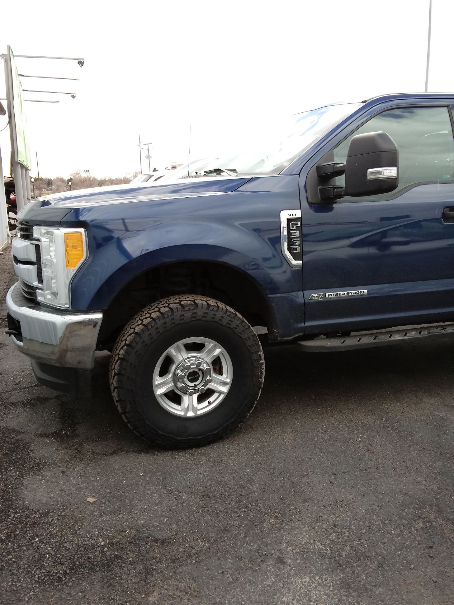

I have stock 17" rims with 35s. Rides pretty well for a one ton truck. I used the balancing beads rather than weights, so no issues with caliper clearance. Beads only cost a few bucks per tire...

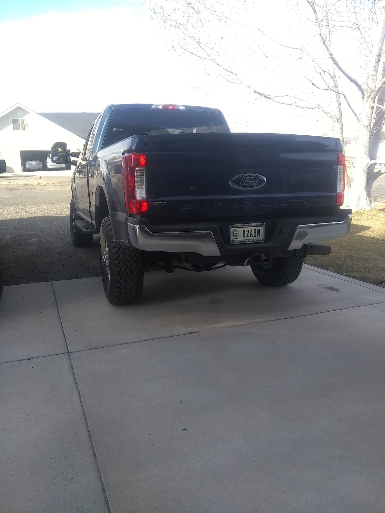

I went from 18" OEM wheels to 17" Method wheels. I cheaped out and didn't use Dynabeads, so the tire shop used stick-on weights. The wheel weights on the drivers front rubbed the caliper a little bit, but after a couple weeks it fully wore in and clearanced itself.
I went with 17's because tires were $300 a set cheaper than 18's. Cheaper tires will pay for my wheels in short order...

We've done quite a few setups with 17" wheels that are properly load rated based on the GAWR and matching tires. Let us know if we can help. The Method NV HD like ATC Crazy has above is a pretty popular option.
