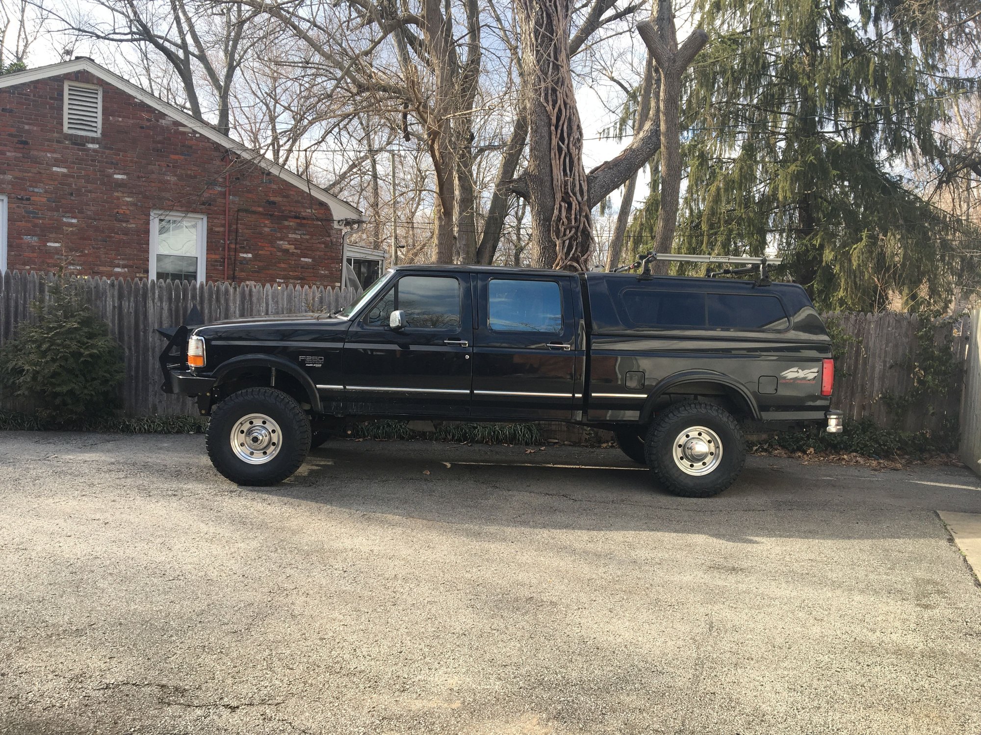

Hey everyone, this is one of my first post so bear with me ... I have a 1997 Ford F-250 SB CC 4x4 7.3
Just had a OBS sky 2.5in. reverse shackle with my stock 215k mile OBS leaf springs installed.
Converted to the Dana 60 straight axle
2.5 lift block in rear, stock springs.
It has pretty heavy weight up front with the Buckstop Winch bumper w/ 12klb winch.
THE PROBLEM I have is truck has so much bounce in the front end, it’s not very drivable. Not side to Side just up and down like a low rider. Definitely cant trailer anything which is what I mostly use the truck for, mainly just a car at a time, not big heavy loads or anything.
Does anyone have any advice if I should:
1. Buy 43-630-HD OBS springs for the front? Will prob lift it another 2in but need to get the ride back.
2. Take off the OBS kit and install the Sky Super duty kit front and rear ( I know that’s what should have been done in the first place)
3. any other ideas?
Advice is greatly appreciated, I’m kinda stuck on what to do next. Thanks

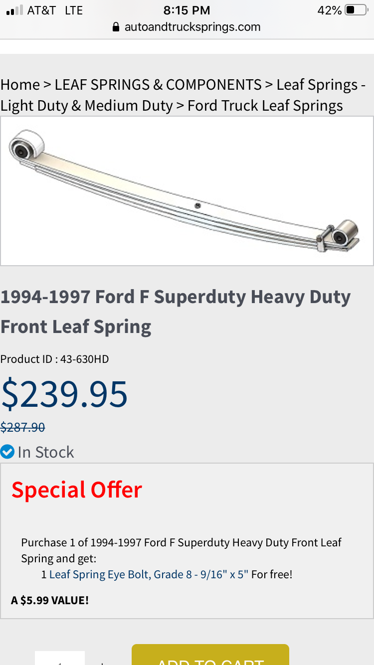

I’m going to post pics of springs I’m thinking about buying. Please let me know if you disagree or have any input on the OBS HD springs for my reverse shackle kit
my only concern is that it will lift the front a lot. Guess I can adapt the rear if I need to.
thanks again!
Old Apr 15, 2020 | 08:01 PM
97-psd's Avatar
97-psd
Joined: Mar 2007
Posts: 4,586
Likes: 841
From: knoxville, tn
I am not smart enough to know if those are for an OBS or not. If they fit then they should work. Are you going to put a brush guard or anything on it? Do you have an adjustable lanyard bar or a drop bracket? With the RSK and the lift from the springs you will probably need at least one.

The image shows up now. It says it is for an F superduty. It may be a little stiffer than needed. Do they have springs for a 350? I would second ATS. They have a good reputation around here. You can get an adjustable panhard for either kit. Mine is for the OBS springs. When I talked to them about different kits they mentioned that smallest kit for an OBS was about the limit before needing an adjustable one. If the springs lift it more you may want to keep the bar in mind
