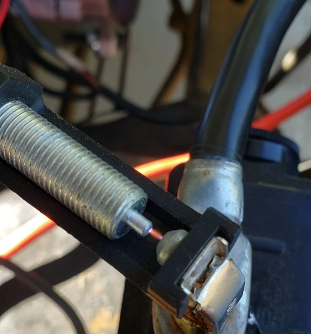

I had an old friend who is on a race team and they rebuild crazy fast engines for their races so I invited him over to see if maybe he could see anything crazy obvious with my engine but after a couple hours of checking everything we were both stumped. Timing was dead on, I was doubting myself so I pulled the front of the engine off to check the timing gears and chain but they were perfectly fine,I had my carb tuned way from where it was supposed to be and I was flooding my plugs so he fixed that for me but after a new set of plugs nothing changed. After a couple hours of cranking it for a while, we were getting a few more pops through the exhaust and now I'm getting some fireballs through the exhaust here and there but she still didn't fire up once!
I got some photos of the spark that I'm getting so I'll upload those but he said even with an orange spark she should fire off at least a little bit.
All of the spark tester photos I had gapped at random to see how far the spark could reach. My plugs are gapped at .044
