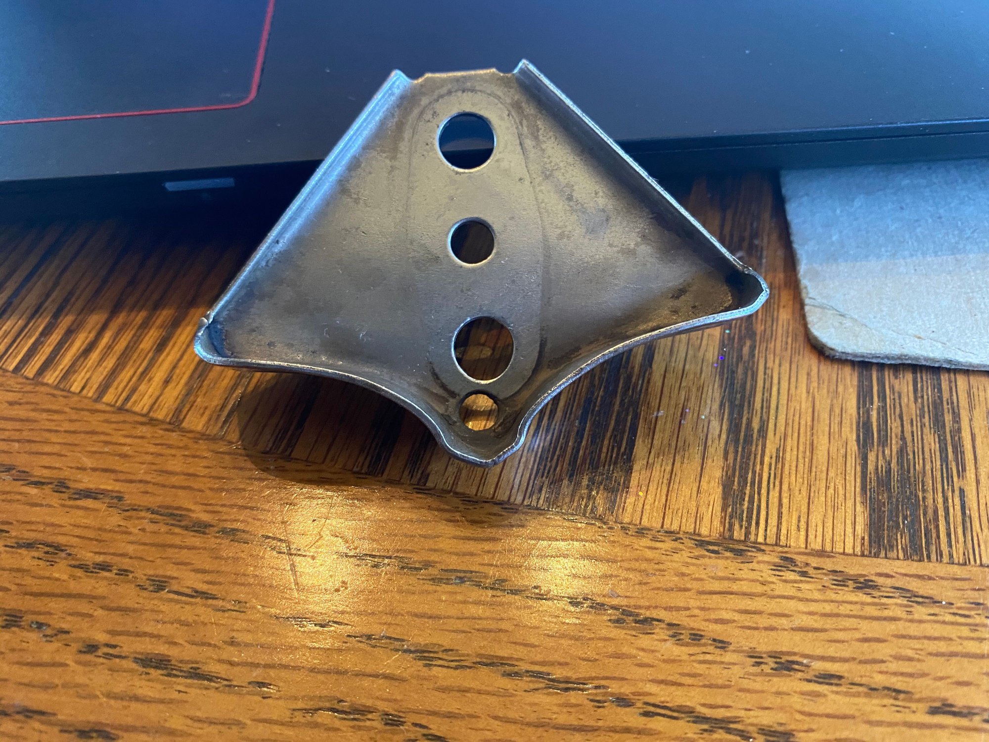

I’m in the middle of a “refresh” of my ‘55’s 239, currently working on the heads. They are the original EBV-C heads. The mystery is that they had the spring baffles (see pic), but the parts manual doesn’t show, or even list, these baffles for the 54 or 55 239s (unless I am missing it). Could it be that the rocker arms cane from another set of heads? Thoughts?

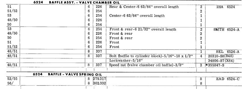

That is an EAD 6524-C Oil Deflector. It routes drip oil from the rocker arms lubrication around the valve seals.
They were eliminated from PASS CAR SVC in mid-56 production but truck kept them. You want those. Removal will disturb valve-train geometry so you will have to compensate for that.

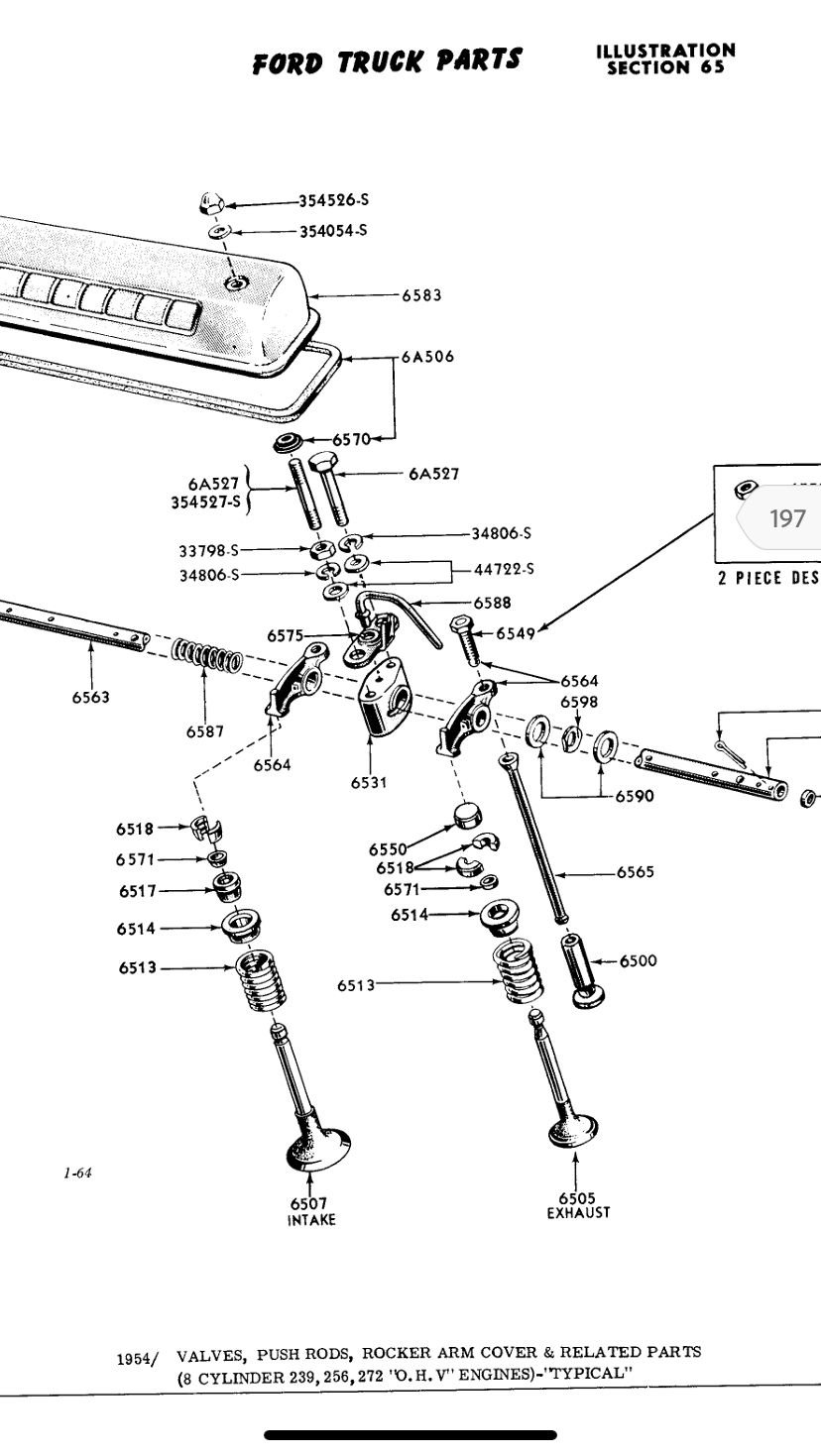

Thank you. I didn’t think for a second that I could leave them off. And I did find the PN in the catalog, but it was shown on an earlier engine. I just wonder why they weren’t included in the diagram for the 239.

Diagram for ‘55 272 shows the part, but 239 doesn’t.

What you are seeing is catalog updates, cataloging usually being updated every quarter.
The second ILL shows 1954/ but the lash caps (6550) shown on the EXH VLV did not come into use on the FYB TRUCK ENGINE until 1957.and the deflectors had been deleted by then.
