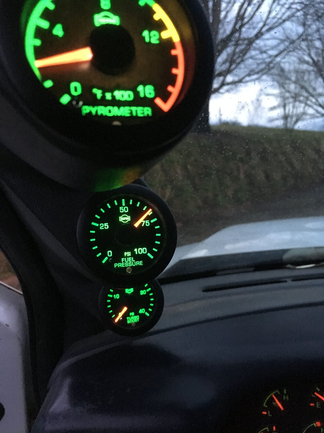

Its easy to check fuel pressure. You can use any cheap 100psi gauge (air, water, etc ) and a piece of 5//16” Fuel hose. You’ll attach the hose to the water drain valve on fuel filter housing and if pressure is good (~55psi) at idle, run the hose up to behind a windshield wiper or side mirror so you can see it while driving.
I greatly prefer and highly recommended installing a fuel pressure gauge on these trucks. This is one parameter that is NOT monitored by the PCM and is otherwise difficult to attain.
