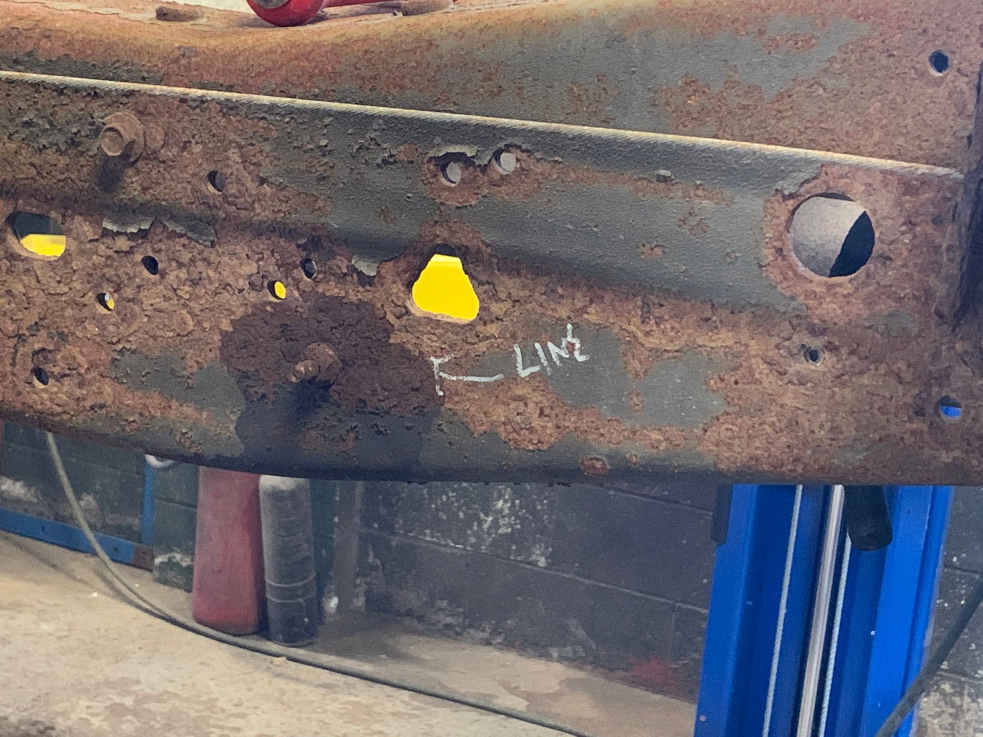

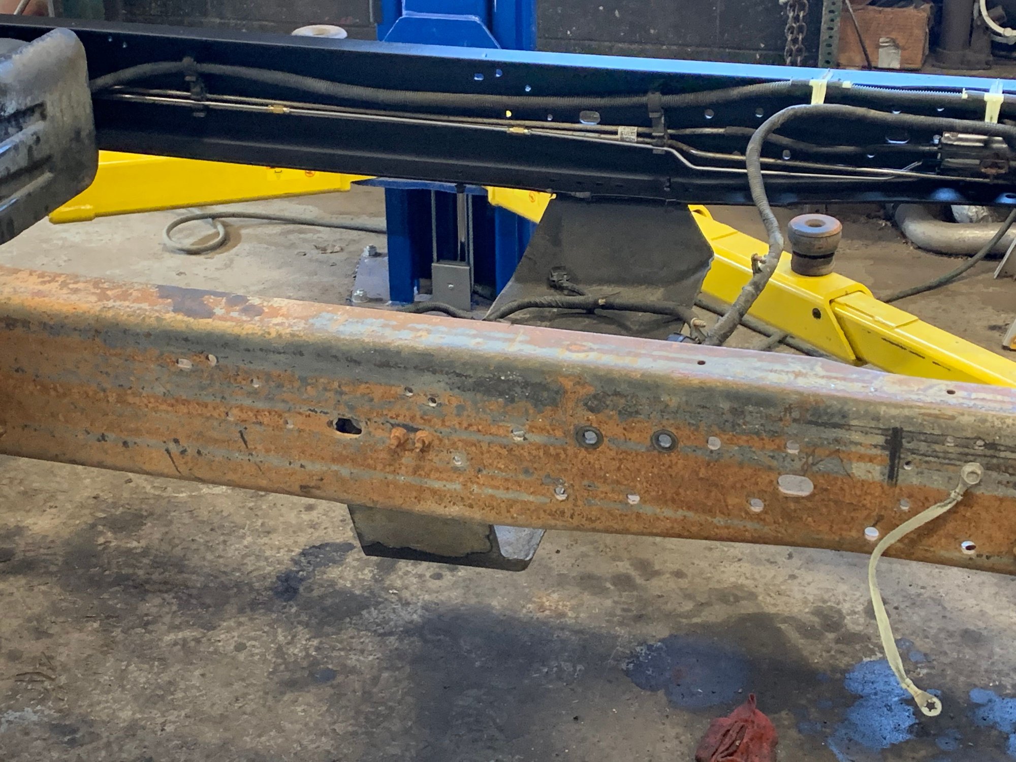

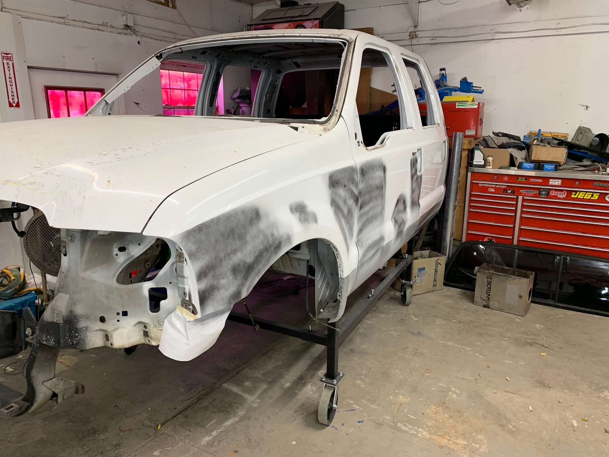

2wd Chassis Torn Down
4wd Chassis Torn Down and Steam Cleaned

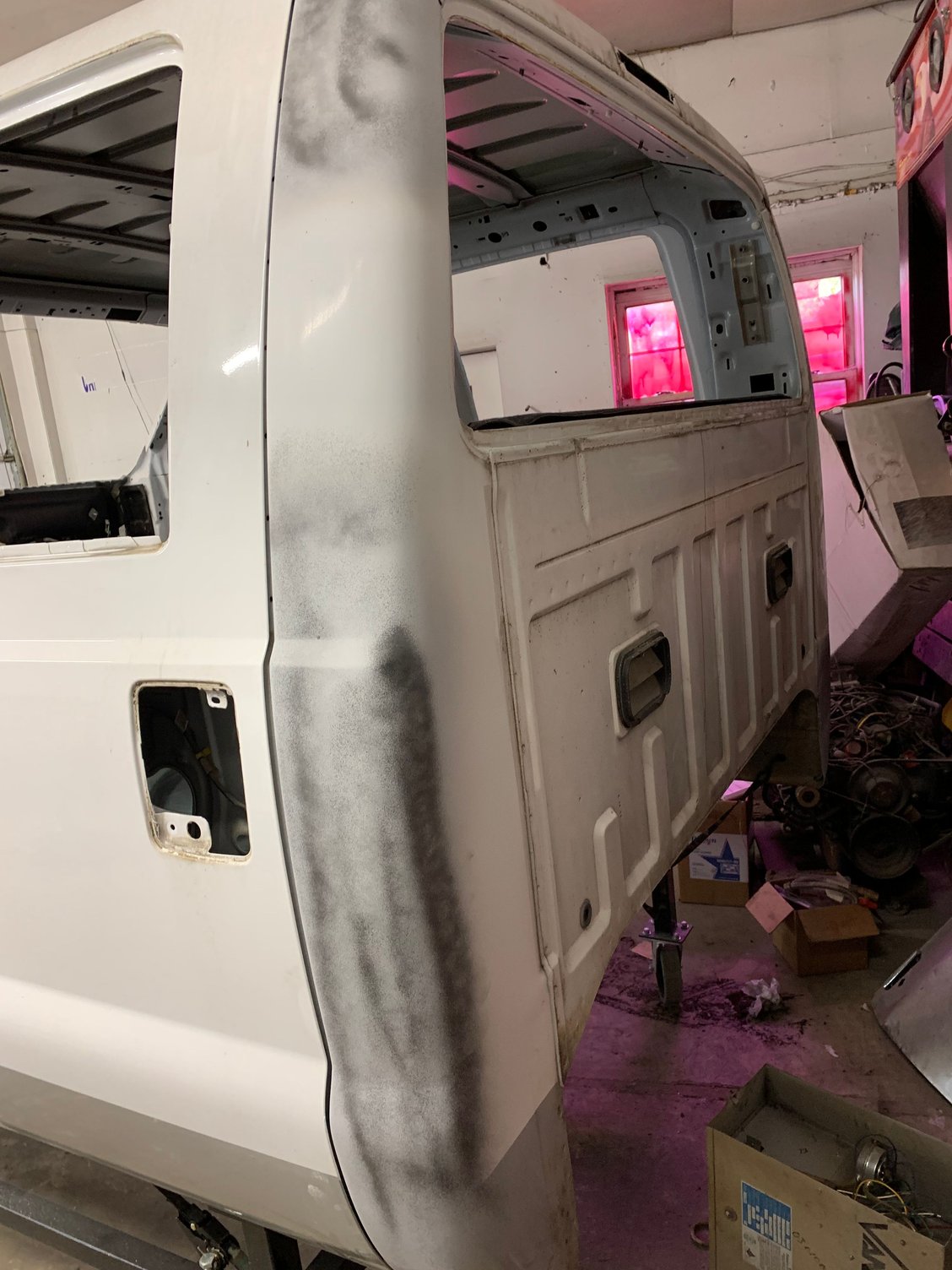

05 Cab Bare Pre-Paint
2wd Cab Tear Down

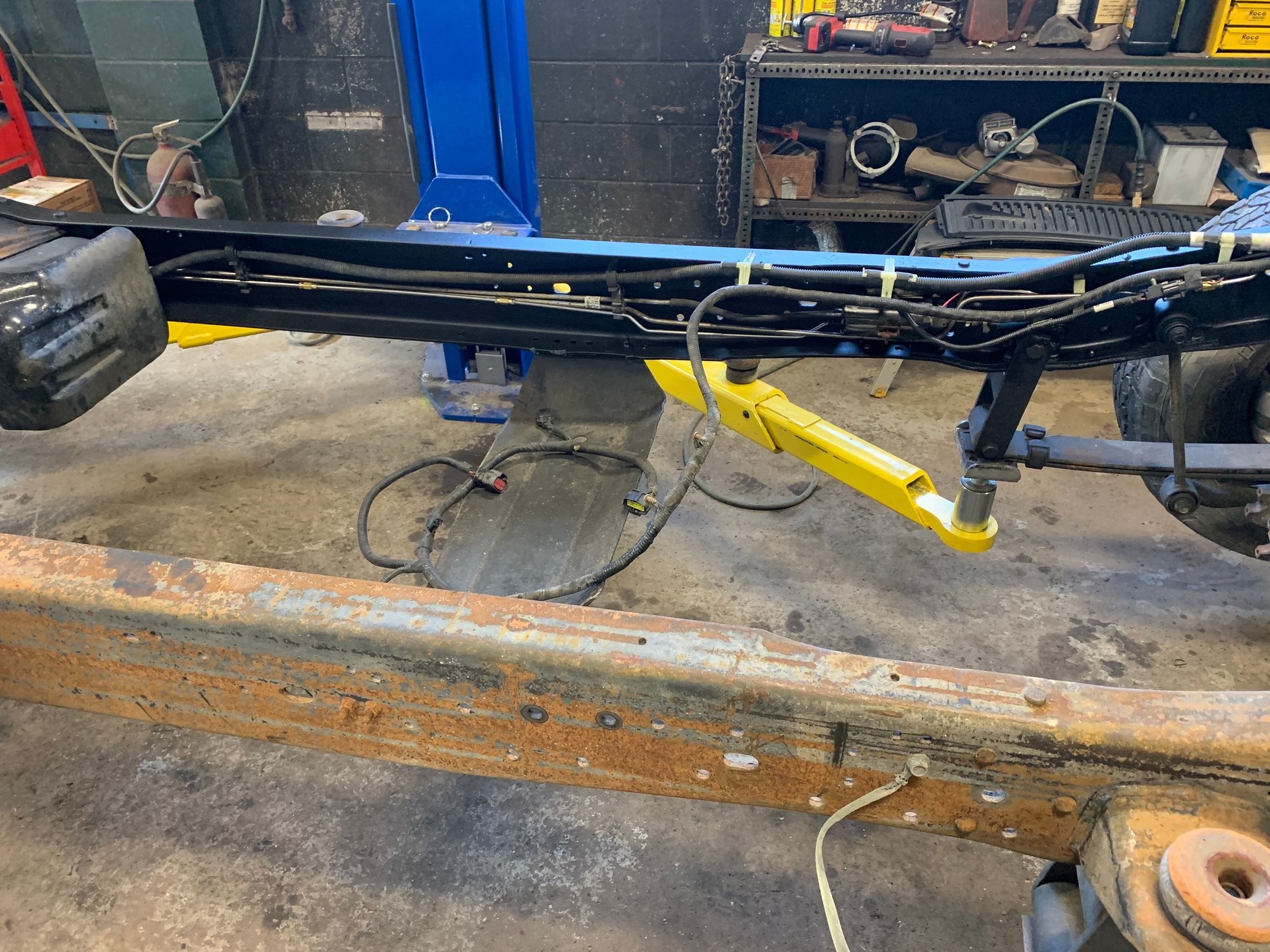

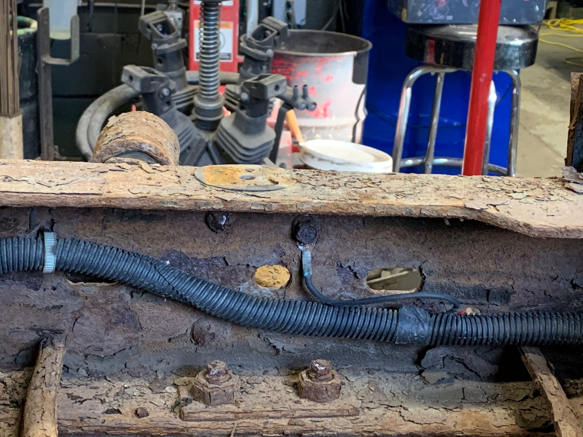

2wd Chassis Tear Down
Keeping Track Of Bracket Locations
