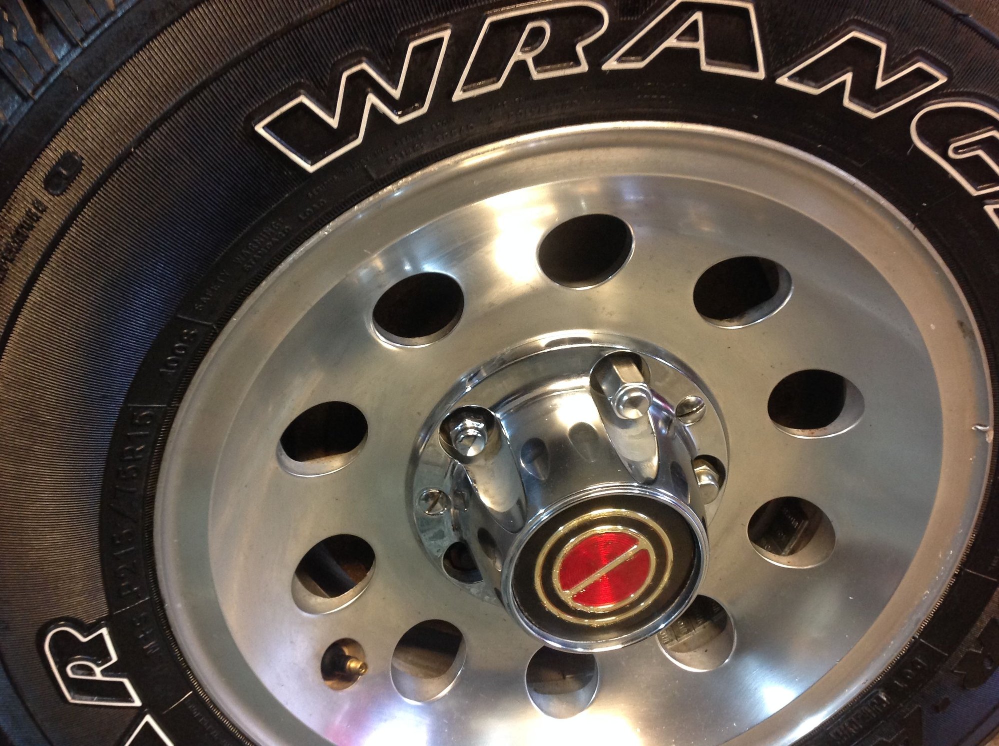

Finished the center caps on the 10 holers on the LH side and installed. The truck has had mile marker front hubs installed in it - will see about painting the dials red.

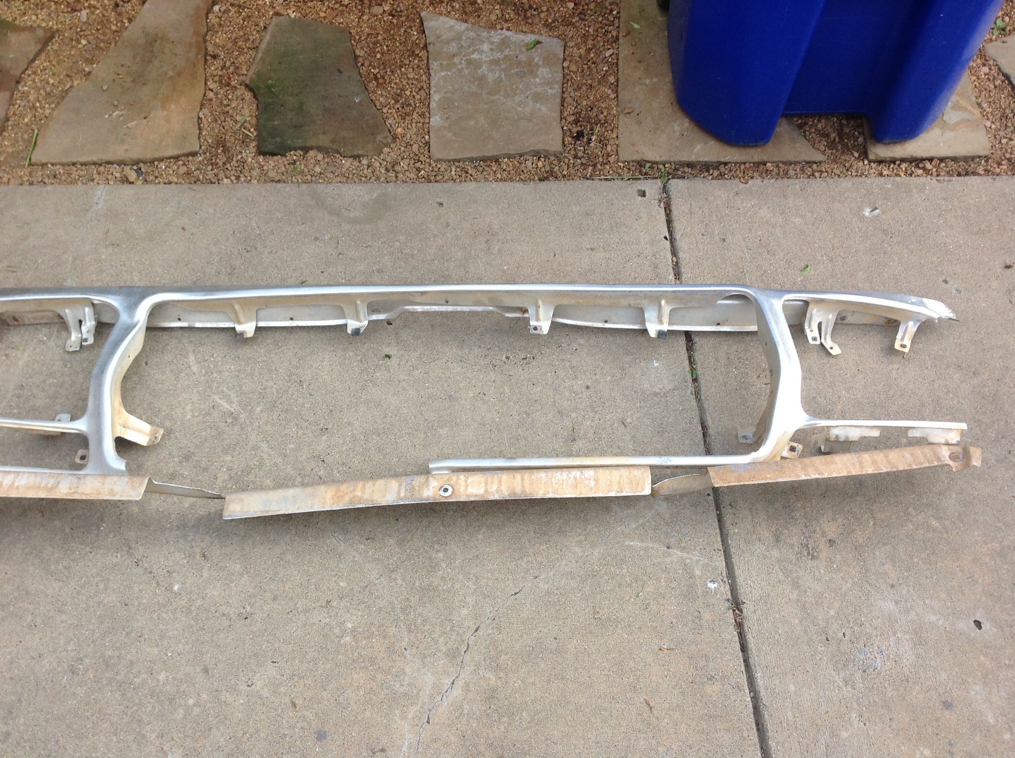

On Monday I got an excellent used from and rear bumper. Almost perfectly staight, which is all I need since they are to be powdercoated. Also got a used grille shell - jury is out whether I can salvage it or not

And, got a killer deal on a grille shell. 5.00 & 50.00 shipping
