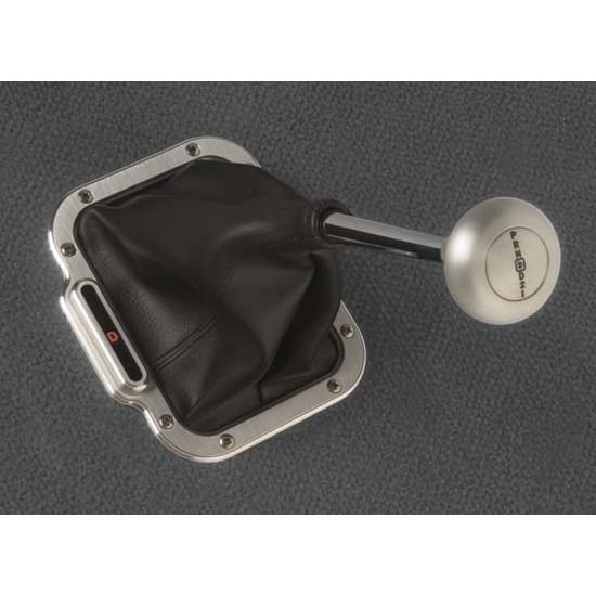

I went with a Ford 4R70W from a 2004 F-150 all electronic transmission which eliminates the need for that fussy throttle linkage. I got the transmission from Monster, the adapter to my original flathead V-8 was from Bendtsen and the trans controller with wiring from Baumann/U.S. Shift.

Thanks for the info and pics. Any concerns about clearance between the bellhousing and firewall/floorpan?

No it fit just fine. I used a Lokar shifter as you can see. The shifter is not in the same position as the stock floor shift. I bought a new trans cover floor panel as mine was in bad shape. But you can easily modify the one you have if it is in good shape.
