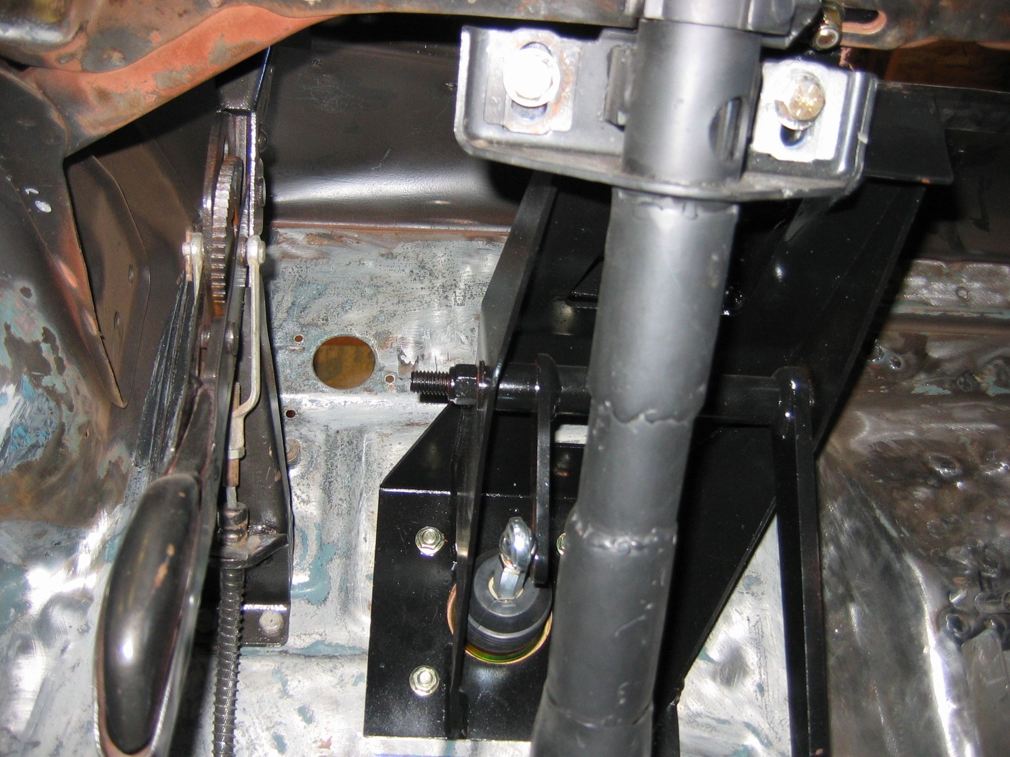

I used one from CPP I think it was for a mid 50's chevy truck I had to modify it. made it wider at the fire wall mount tied it to the dash and steering column the only down side is the peddle is a little high from the floor I may be able to adjust that? i think the booster is a 7"
the big hole on the rt is for the elect connection through to the cab the hole on the left is for the pcm cable

you can also see the throttle cable going to the peddle this before I changed the fuel injection to an explorer gt40
