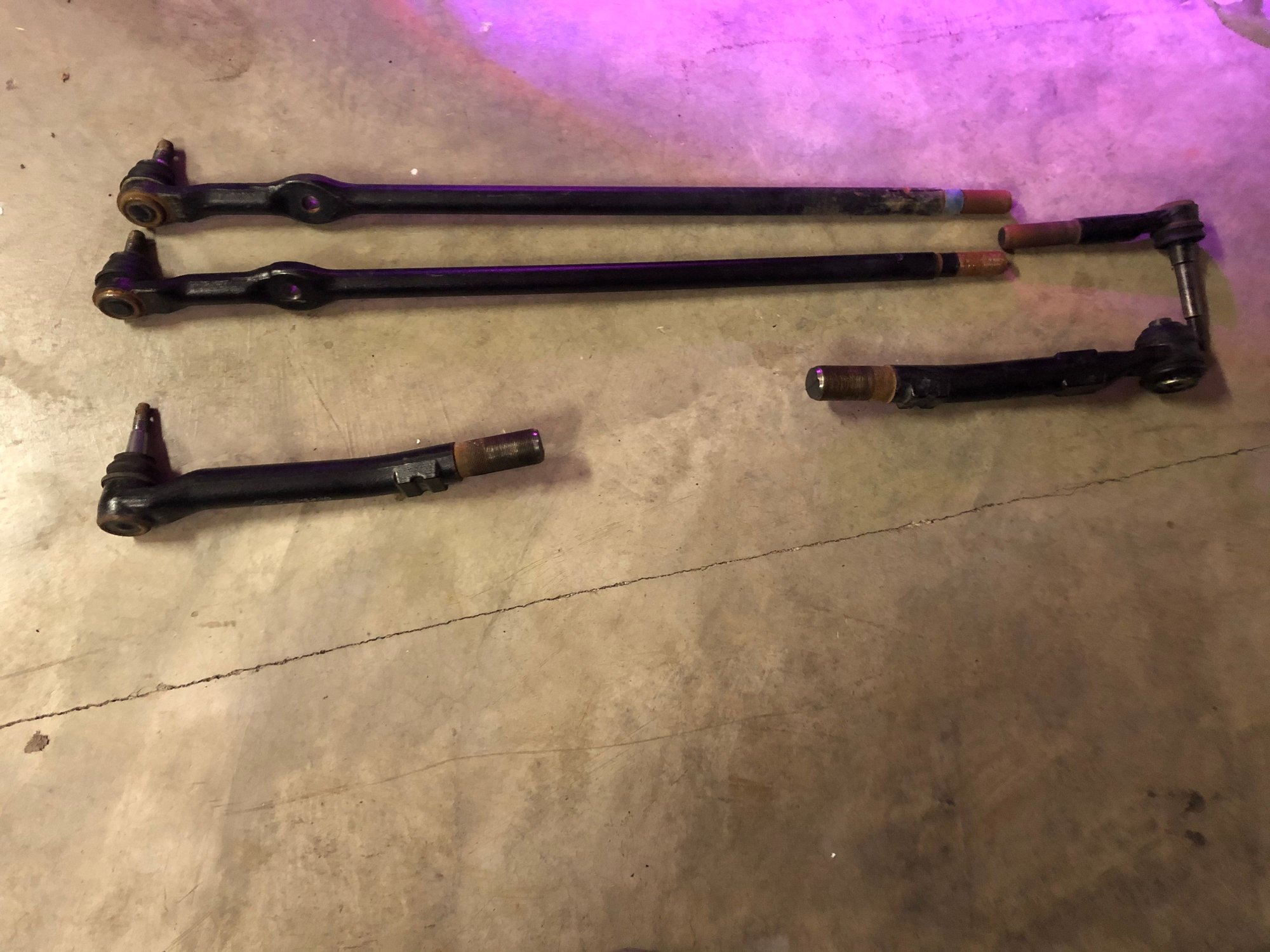

Ive had the same problem the OP describes since day one on my 18 350 drw that now has 34,000 wandering miles on it. Im slowly replacing the entire front end of my $65K wander machine. FUN. 3 Ford centers say its perfect. HA! Watch out for that honda civic passing me, blows my 8,500lb truck off the road. Perfect huh?
First original drag link ball joint was bad from day one. New motorcraft drag link from ford parts counter & it was bad out of the box. Sloppy vertical play at the drag link ball joints.
Im still hearing clunks over bumps. Suspecting drivers side ball joints or wheel bearing.
My bad Motorcraft parts pile that will grow.
