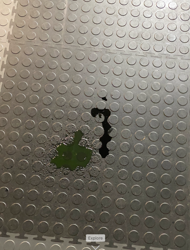

Name that leak...
It's much easier to diagnose on the garage floor than while parked on the grass.

Oil cooler seal against block

Makes sense to me. Do the o rings too, obviously.

I've been waiting until it warms up so I can do this messy job outside in my yard but I recently got a large drain pan that I hope will catch the antifreeze - I'm now going to do it in my garage.

Be sure and use assembly lube on your new O-rings.

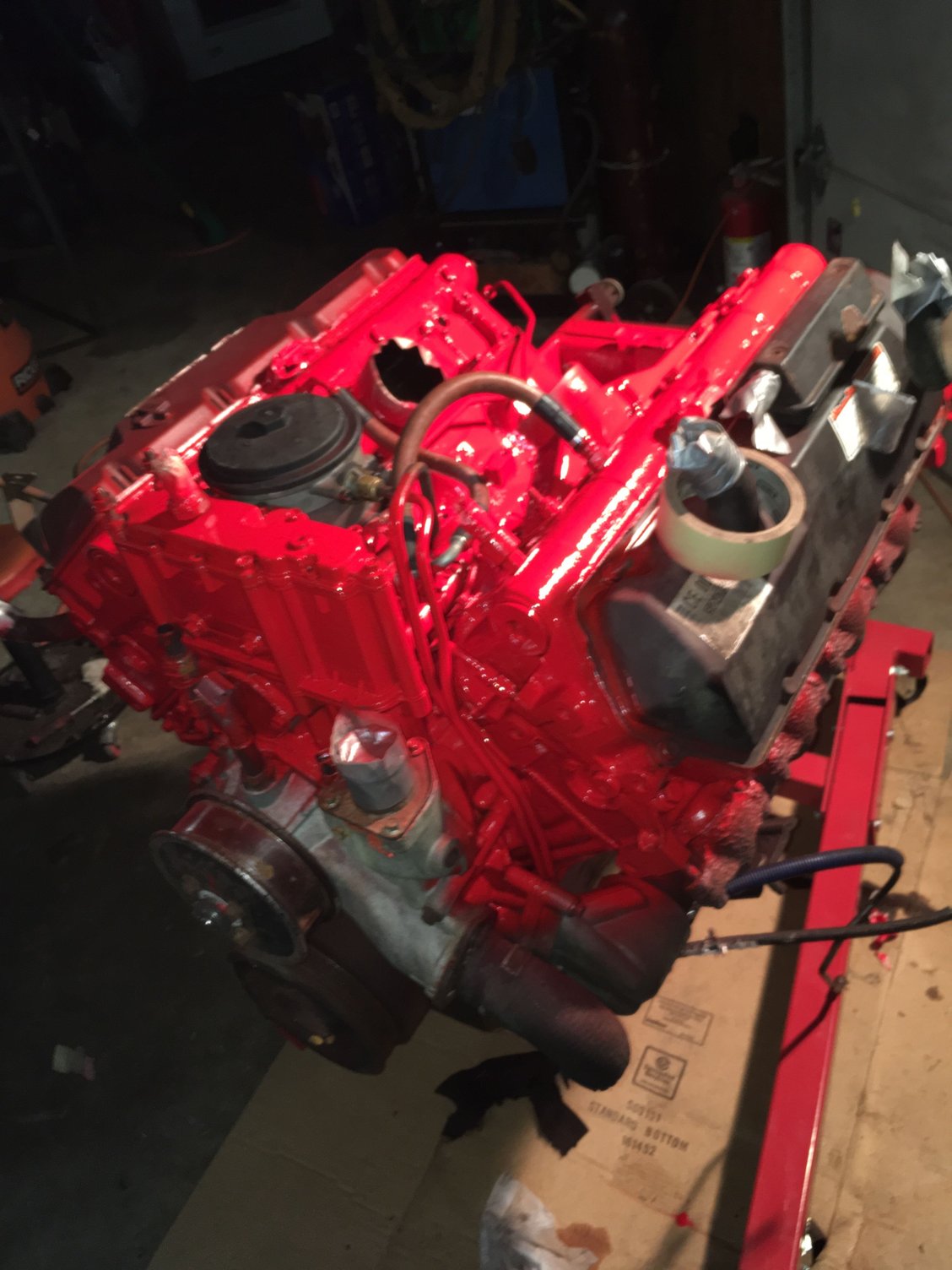

If you drain the oil and coolant including pulling the drivers-side block drain, it’s not that hard to manage the mess. After draining, loosen cooler bolts and pop the rear of the cooler off first and let what little fluids left in there drain into your catch pan.
Nothing to it!!

@SkySkiJason Thanks for the advice. Great pics!

Can I ask is high temp paint you use on the cooler parts?
Old Mar 6, 2020 | 05:59 PM
SkySkiJason's Avatar
SkySkiJason
Joined: Jul 2008
Posts: 12,782
Likes: 2,142
From: N.GA Mountains
Rustoleum 2x enamel. It’s good for everything except exhaust parts. I use VHT header paint (2000*) and bake it per the directions.
“Engine paint’ is a gimmick. Any good enamel will tolerate 500*F. Don’t expect fantastic color retention - this paint will fade to a pastel eventually. But, still looks better than RUST!
For more protection in rusty climates, apply a few coats of self-etching primer first. Thickness counts, but follow recoat times on label.
