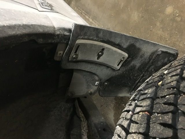

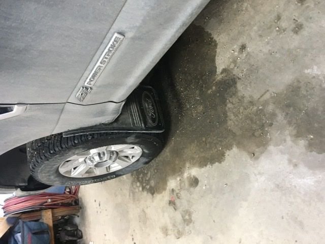

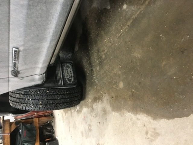

So to me my mud flaps looked too short. So I lowered them making new holes in the ford aluminum mud flap brackets. Used stainless screws and nuts. These Michelin tire throw so many stones on the gravel to my house it is enough to cry. So this can only help. Flaps are two inches lower than original locations. Which negates the 1 1/2” I levelled the front plus put them an extra 1/2”

Just be careful while backing up now. It looks like the flaps are within a few inches of the ground now. I work at a construction company and our trucks are off road all of the time. Some of our stock pickups have had the Ford brand mud flaps ripped off while backing up over a curb or out of a subcut. All it takes is to pinch the flap between the tire and solid object like a rock, curb, etc. and the tire will tear the flaps right off. They tear the bolts/screws right out of the body of the trucks. I know are trucks are to the extremes of use and abuse but it can happen in any situation that the flap gets pinched. It happens all of the time on our dump trucks, all it takes for them is to back into a pile of dirt, pinch the flap between the dual tires and the pile of dirt and the flaps are laying on the ground.

Pictures are deceiving. They are not that low. Actually 10” off the ground. I figure 1/2” lower than stock due to the 1 1/2” level in the front. Last truck I had put chains from the middle of the flap to the frender to stop the possibility of ripping them off. If I can find stainless chain maybe I’ll do the same.

We have ripped off the stock height flaps, but like I said our trucks live off road in places where most wouldn’t think about driving... heck some of the guys have torn off the running boards!
