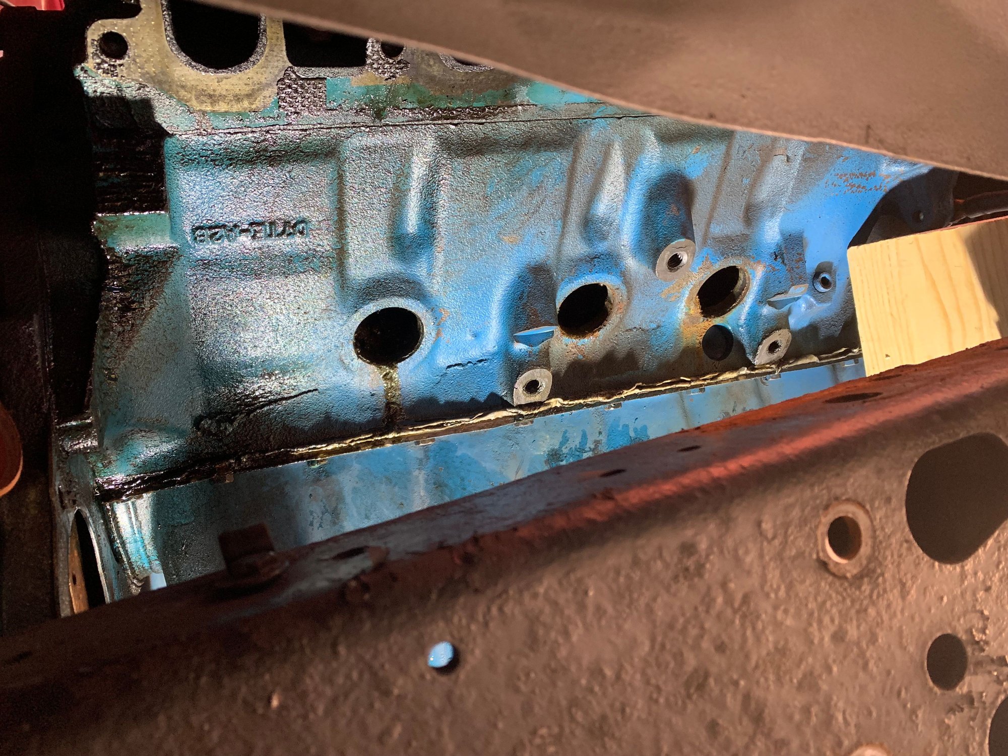

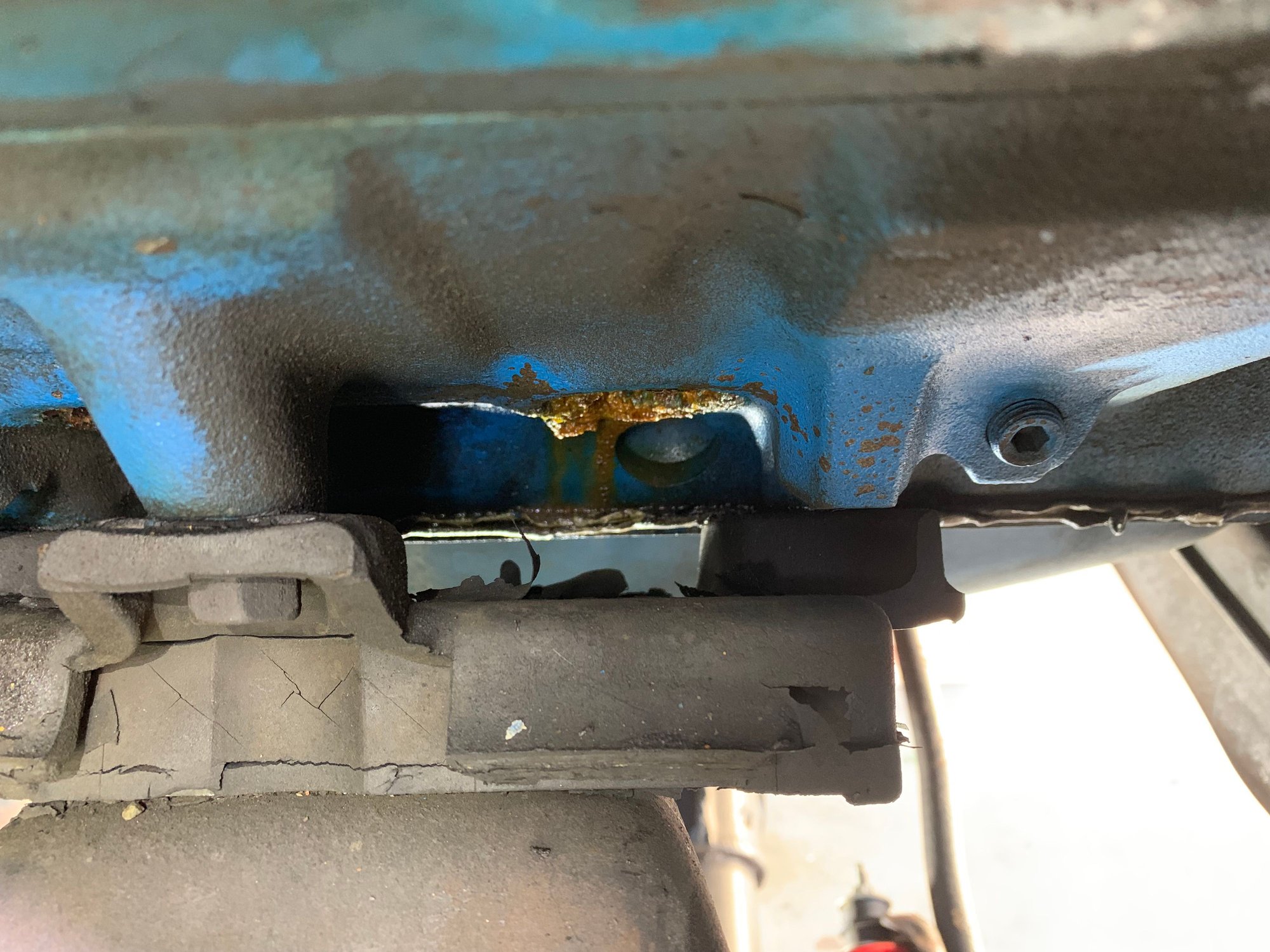

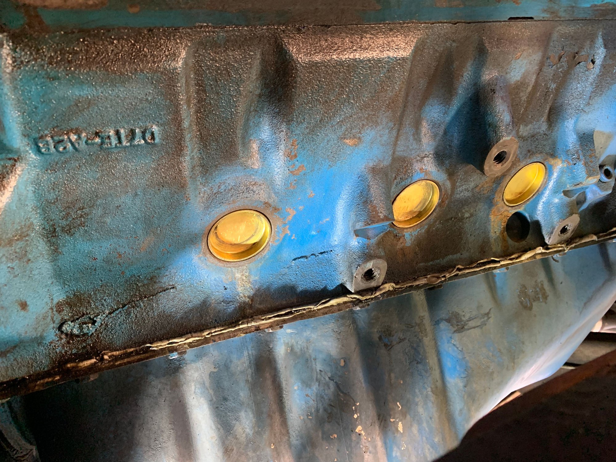

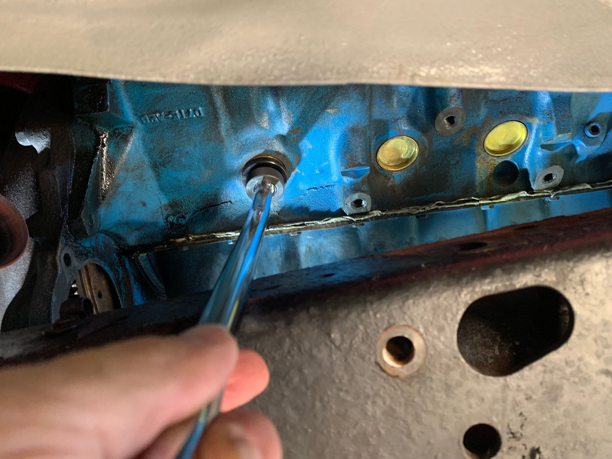

ello Candy Cane fans! Yes I'm still here, I have been busy with work and I also have another classic car that I have been working on as well. Last summer I finally fixed my leaking freeze plugs without pulling the motor. I removed the wheel, removed the right side motor mount and supported the engine with a 2x6 that I was able to wedge against the block. This allowed me full access to the freeze plugs. They where so badly corroded that one of them let loose on me just as I was scraping the rust away so I could see the plug. Removal was pretty easy but installing the new ones was a bit of a challenge that involved some cussing but eventually prevailed. So prof positive this can be done.
