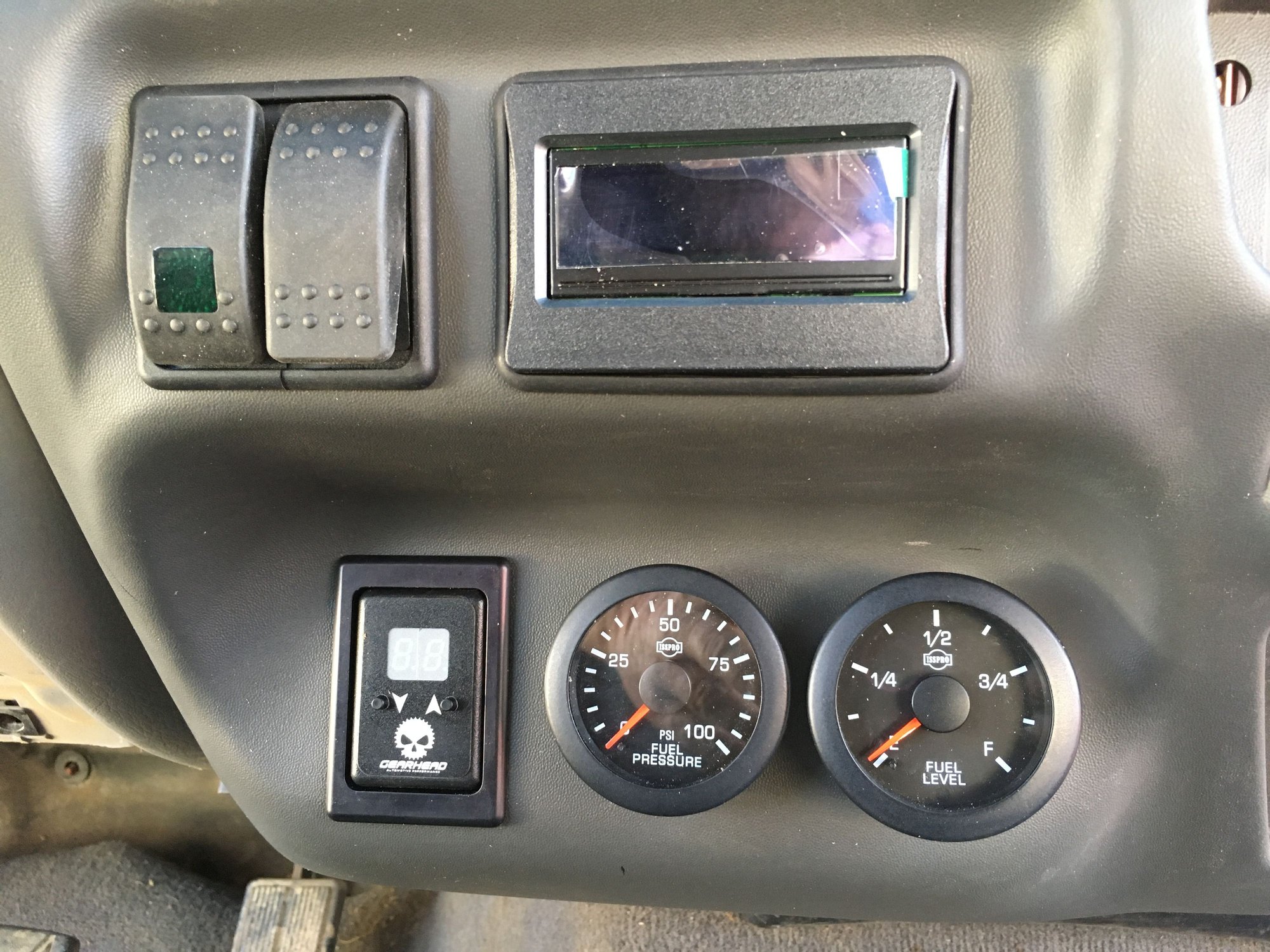

Originally Posted by brian42
x2 for ISSPRO EV2. I had 5 gauges with dimmer switch (https://www.riffraffdiesel.com/poten...-wire-harness/) and never had an issue.
Looks like you've installed the black FPR spring. I couldn't get myself to go higher than the gold one.
That was while messing around with a failed FPR recently. I tried replacing FPR internal o-rings and shimming the spring while waiting for new FPR to arrive. It didn’t work. Lol. Would not maintain pressure under load...
I’m always shooting for 55-60psi. There is no advantage to higher pressure.

Hey SkySkiJason, did you install that fuel level gauge because the factory gauge didn't work right? Mine gives wacky readings until the level drops to about 1/4 tank.

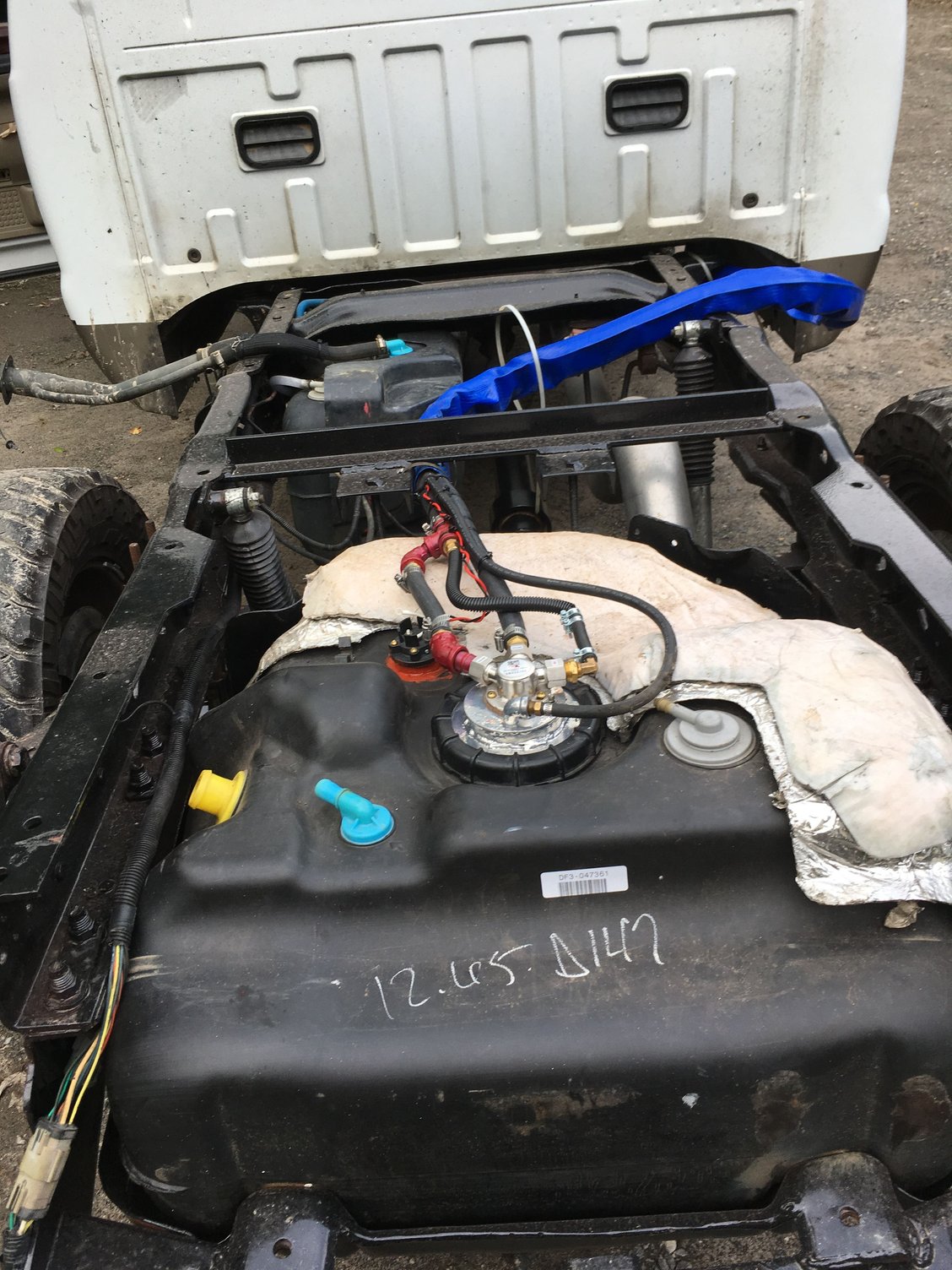

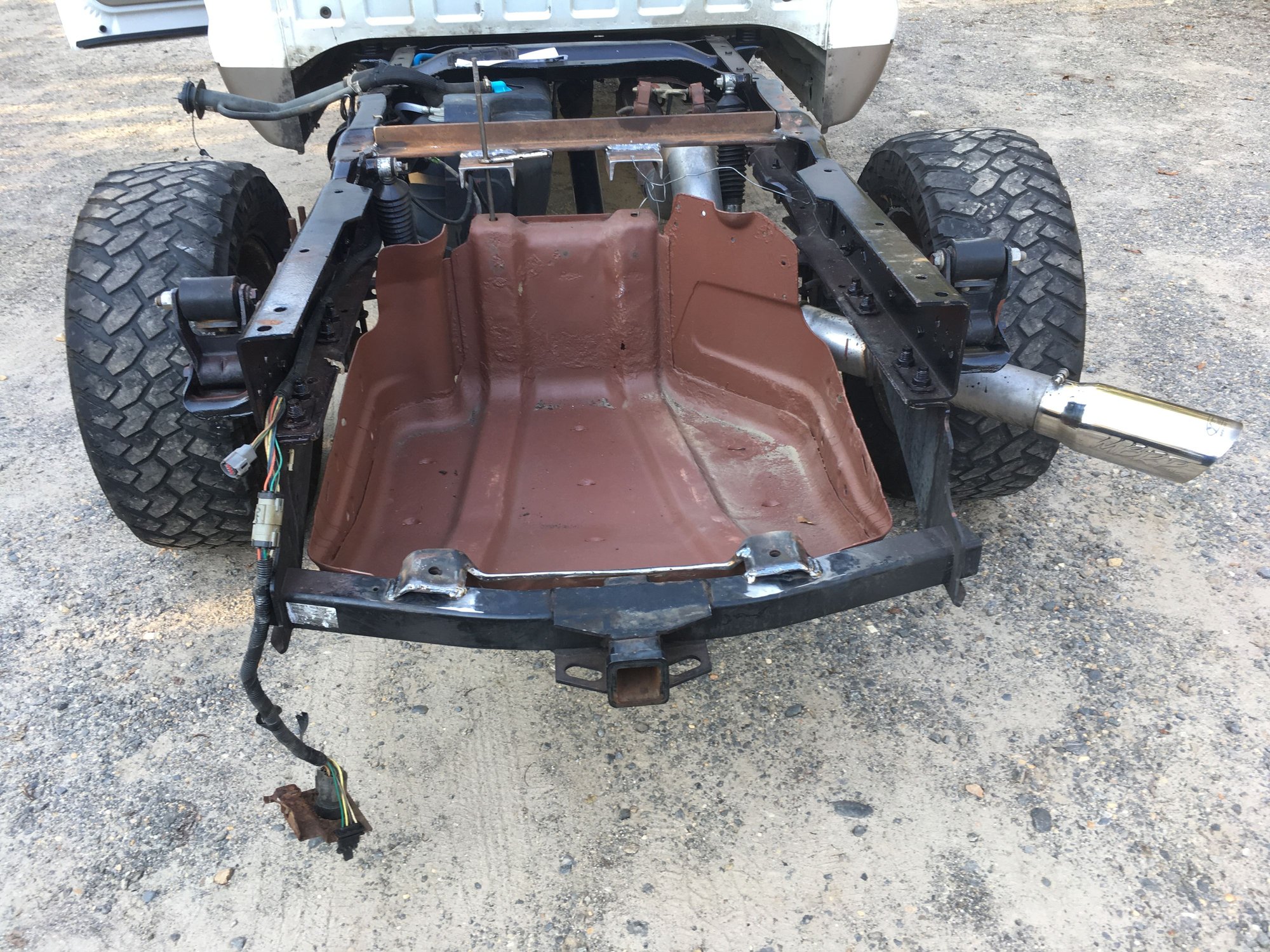

Originally Posted by Wes444
That's his WVO tank level
Wes is correct. We use a 2nd tank for vegetable oil. I often use an Excursion fuel tank in the spare tire location in F250/350. Like this.
However, you can see here I’ve added an ISSPRO fuel level sending unit to the tank. We can order those in the correct ohm range for the factory gauge and replace/upgrade the factory sending unit. They are currently about $100.

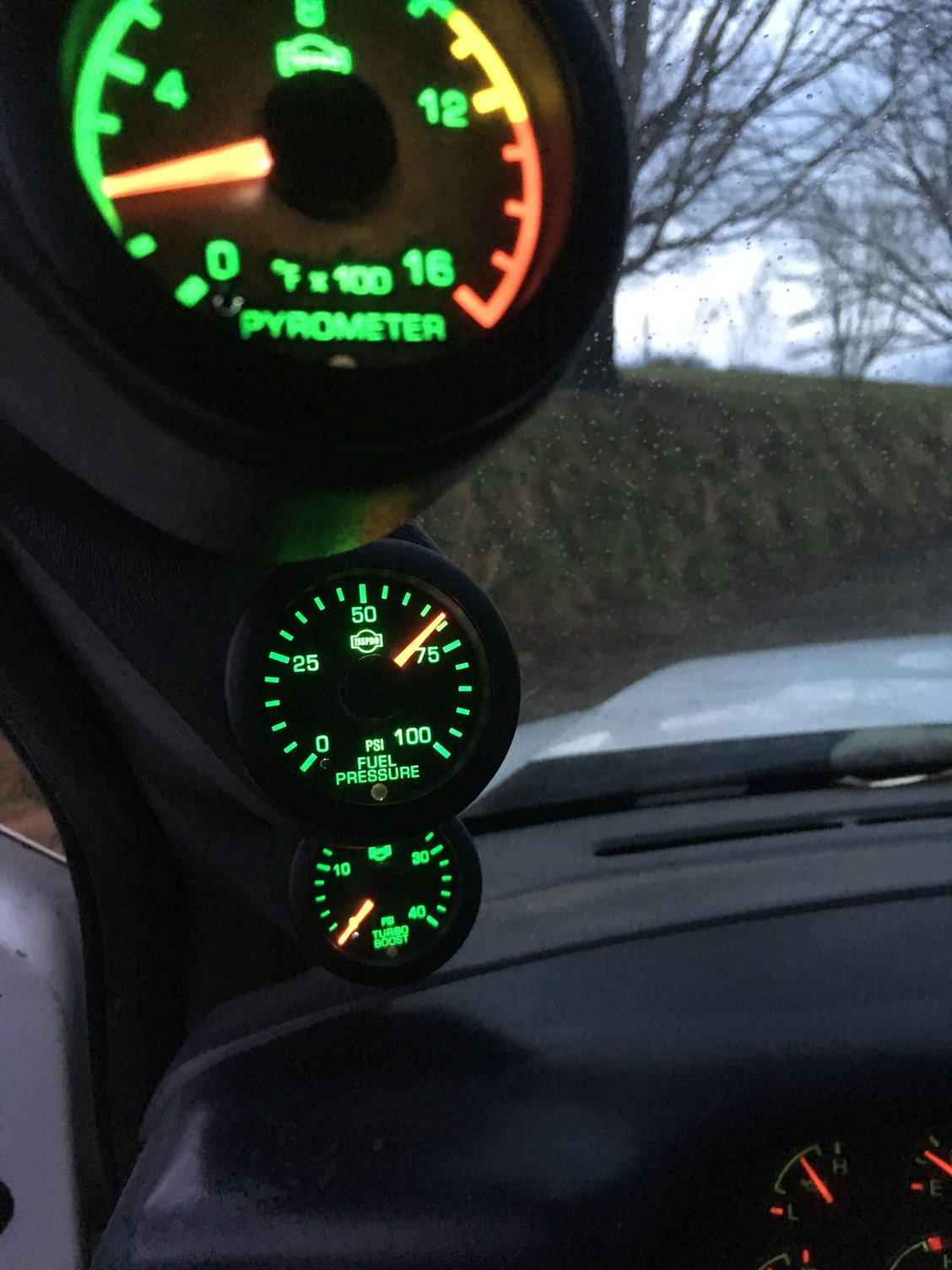

Isspro all the way, the EV-2 are LED but they dim fine after installing the extra potentiometer under the dash that you adjust to match your factory dimming then never touch again.
Old Feb 28, 2020 | 04:29 PM
F0rdc0wb0y's Avatar
F0rdc0wb0y
Joined: Jun 2015
Posts: 1,635
Likes: 564
Another isspro user here. I installed the dimmer switch ( potentiometer) when I did my gauges years ago and found that you can only adjust the brightness down so far before the gauges start to flicker. I believe it has to do with the gauges being led. I might be wrong though. I leave mine turned all the way up.
