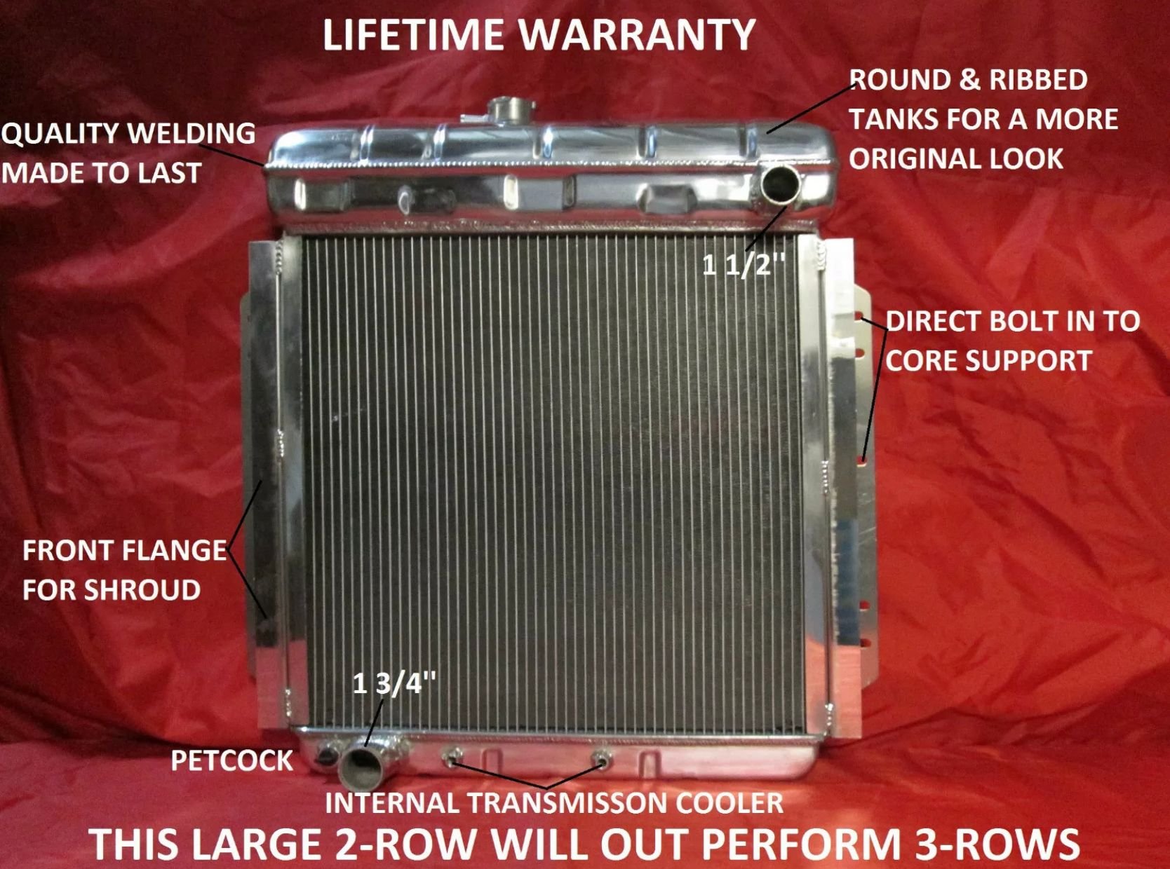

I bought this on eBay https://www.ebay.com/itm/1953-1954-1...-/291662892598

That's a nice looking radiator for the price listed on eBay. How did it fit, any issues or modifications needed to get it to fit? My preference is to buy US made products, but the price of a US made radiator is ridiculous.

56_f100 Fitment was good. I’ve got a aftermarket electric fan and shroud on mine but seems to work well.
Hooler1 they are supposed to be lifetime warranty. Might wanna check back with them if the leak starts back up.

I just bought this radiator with shroud less the cheap fan and went with a spal electric fan and I'm happy with the look and quality. This has the correct outlet on the passenger side.
