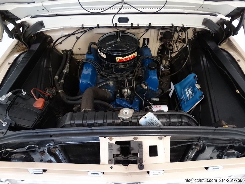

Here's a pic of a low mileage truck and if you look at the clips on the cowl the farthest one on the right and the 4th one from the right are the two that support the washer hose line to the "T". Same distinctive olive green color. Not that it matters, just so you can see the location of some originals.

Perfect. That's what I wanted to see. Thanks again.
