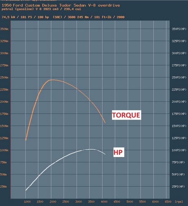

What book says flathead power is at high revs? Unless they are drastically ported, they are out of breath by 4000 RPM or less. A stock EAB Ford or 1CM Merc cam was the best the factory could do
This is the dyno of a stock 8BA
