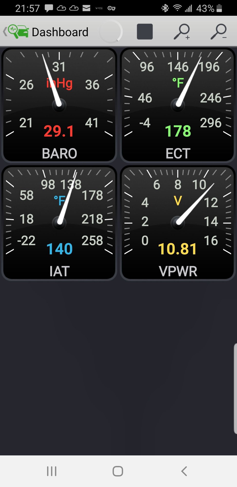

Forscan is adjustable. Is that what you mean by zoom? Like this.

Yah.... In a way. If I have ___say 6 pids up. (I use about 10). It will cut some out. With torque I can run 8 small and the big ones(ECT and eot) on medium. I keep all in screen and can read with out me reading glasses. 😊😊

Yeah it should fit to screen no matter how many. None should cut off. The only time I have that many up is for diag on a truck or the bi-annual inspection.
This is my full diag screen. Not for everyday driving.

Yup. I agree with the way it looks.
this is what I use in my console cup holder. Easier to read. Getting old. Can't see them small pids on Forscan.
