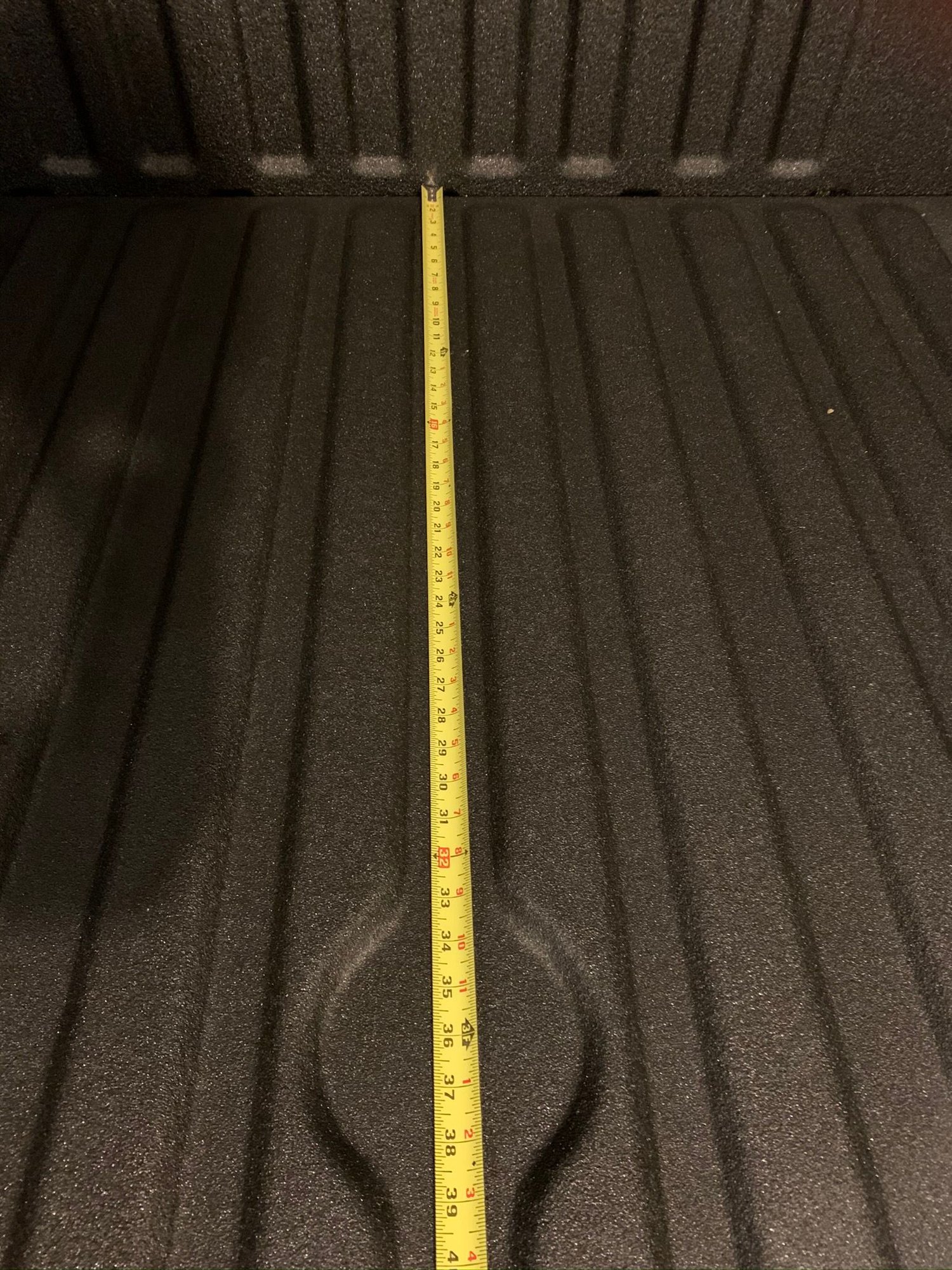

I don’t have the prep package, but about 36” measured from the front of the bed to the center of where the ball would go.

Thanks Jason. Even with the offset I can get from some of the gooseball mounted hitches, I don't think it would be enough to clear the cab. Better stick with a slider hitch I guess. Damnit I was hoping I could get something that doesn't weight a million pounds.
