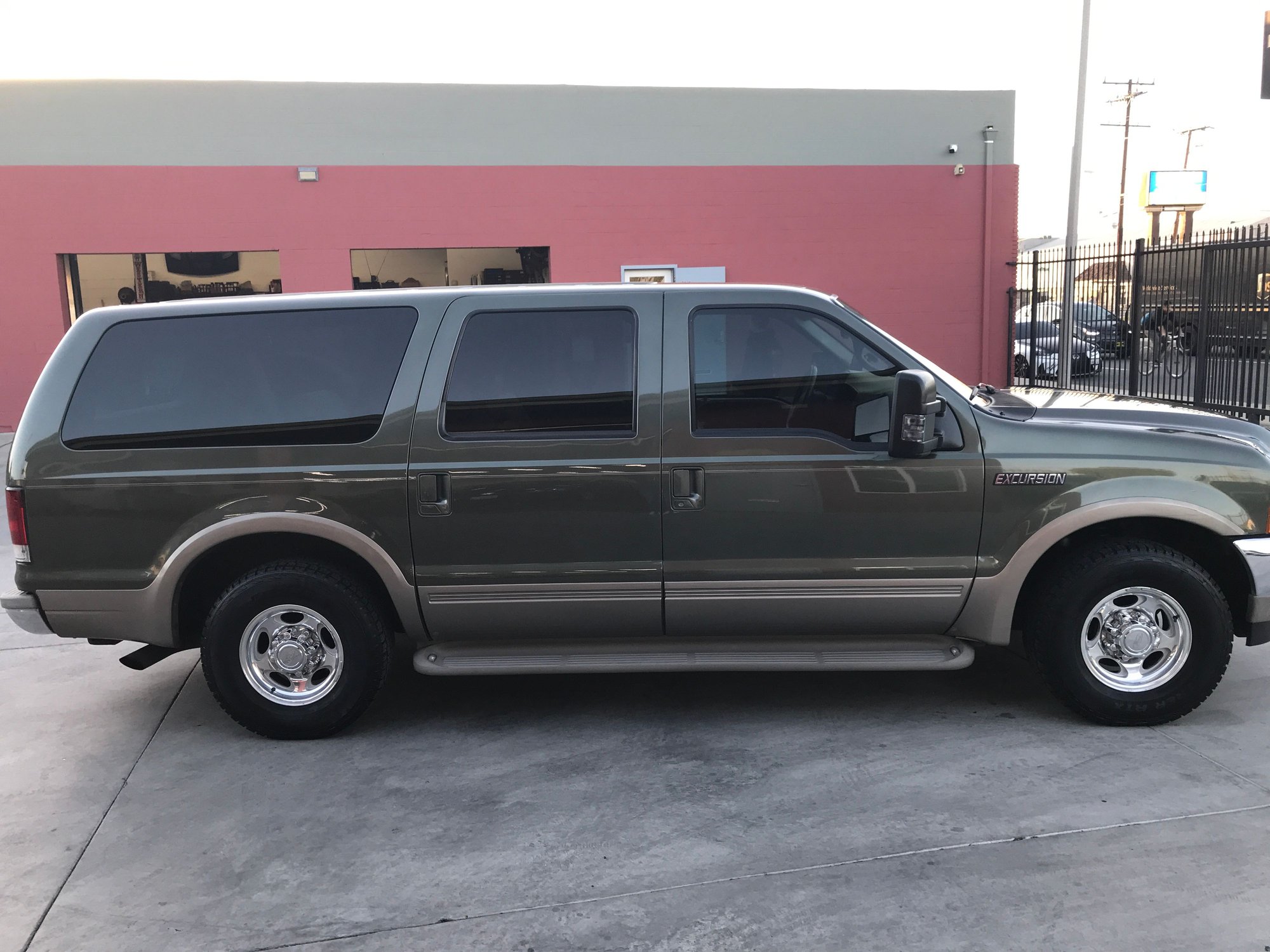

and I'm sure a few more items I haven't found yet. Here's a picture below. She shows much better in pictures.

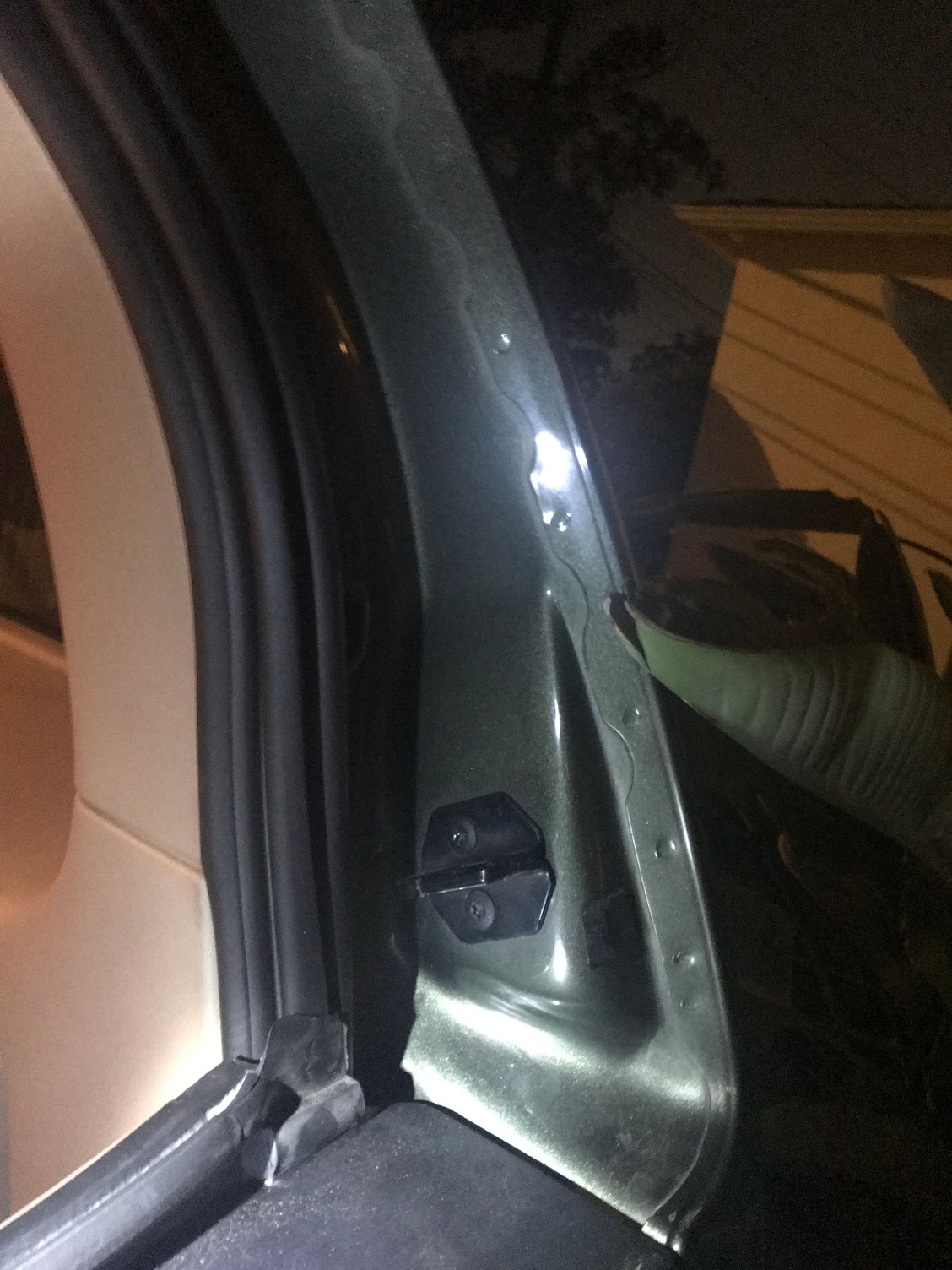

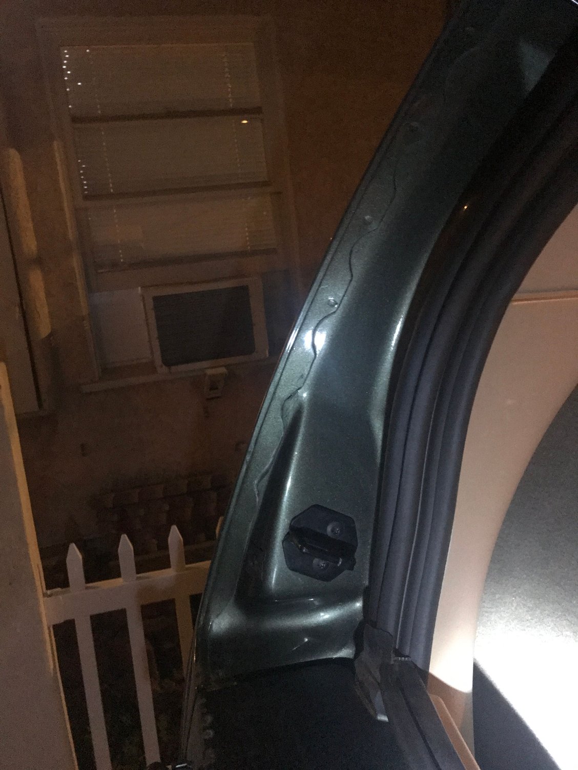

can you post pictures of the evidence of the quarter panel being replaced ?
i recently removed a quarter and want to see what to avoid during install.
my main concern is the 3 layer roof seam.

The only evidence that is visible from my view was the spot welds along the upper hatch jam. If you look along the jam area you will dee indentation "dots". That is where the spot welds are. On mine, from half way down the left side between the upper hatch hinge and top of the barn door. From that point and lower you cannot see the spot welds. They must have used body putty prior to paint. Also inside the fuel filler tube had red (the color of the donor vehicle. Additionally, around the edge of the fuel door you can see some red that is barely noticeable.
the spot welds are not s good indicator, there are several places on the vehicle that ford covered them with body putty and some places that were not covered but the typical weld spot was not not easily visible
have any pics of the red ?

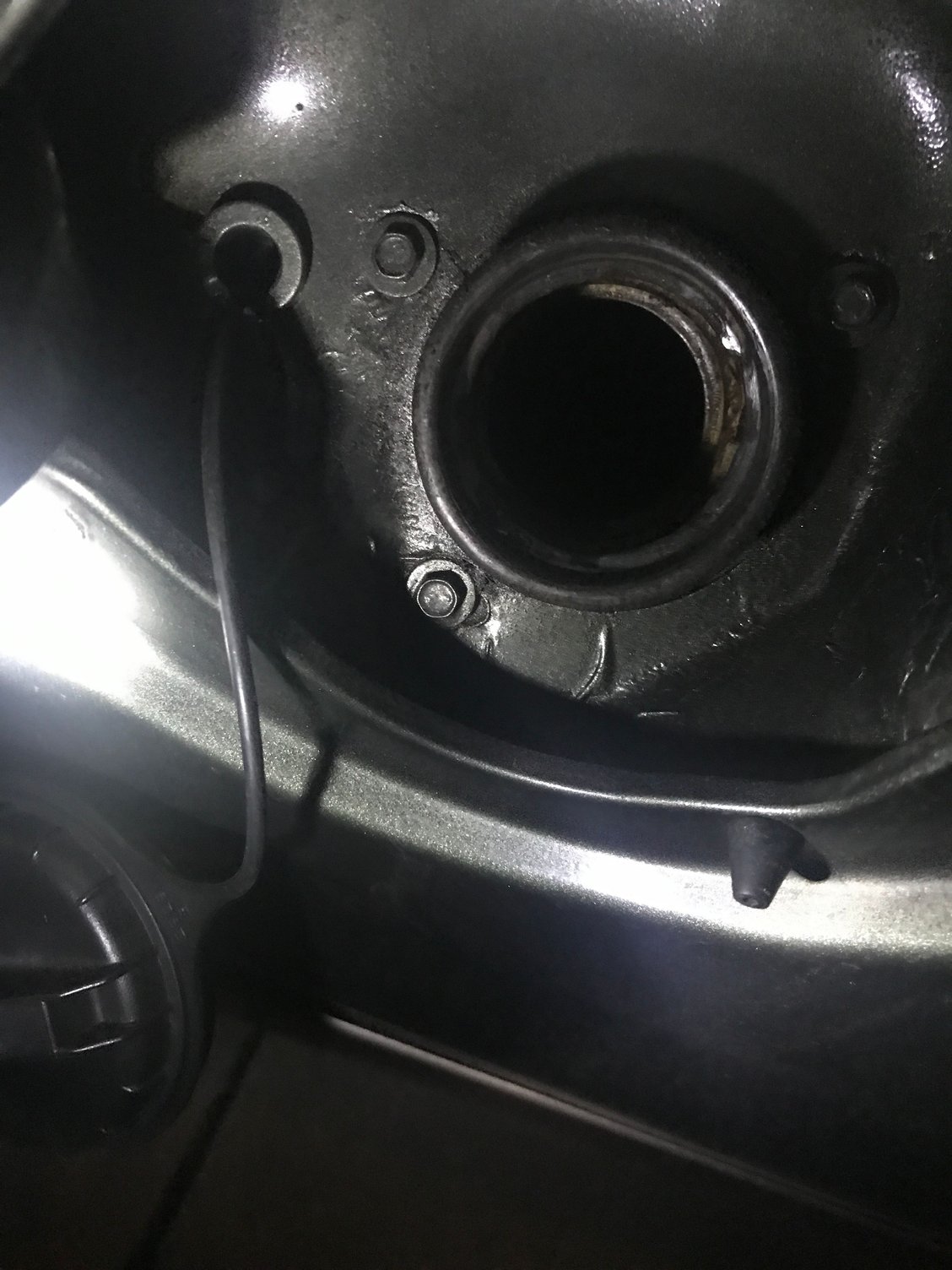

I have already covered the red spot inside the fuel filler compartment with touch up paint. There is a little haze around the edge of the fuel door that I'm unsure if touch-up paint will cover without making a mess. I doubt it will show up in pictures.
Also I noticed the nozzle restrictor isn't there so I could fill up at a truck pump if I needed to.
The crappy area about 7-9 o"clock is where the red was.
Notice the spot weld holes all the way to the bottom
Notice the spot weld holes only half way down
