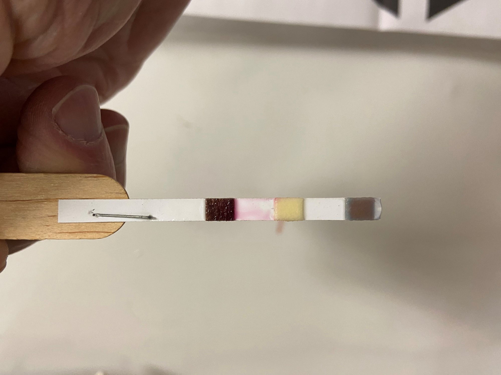

As the title states - who understands SCA? I changed my water pump in Oct. '18 (early '99) and didn't drain the block. Green coolant was
really clean so added 50/50 and I believe 3 bottles of Motorcraft SCA. I'm just now testing with the Acustrips I got from the dealer. Which line is the most important? As far as freeze issues, I know I'm fine just given the clean rich color in the degas bottle. Is the Ph or Reserve Alkalinity the most important? Is it possible to put too much SCA in the cooling system?
I appreciate any assistance.

Why did you add three bottles? Yes with that much SCA you compromise the chemistry of the coolant and also create fall out. The nitrates are way high and should be near 1.0-1.2.

I used dialogue from thedieselstop.com as my guideline but possibly didn't follow correctly. That information may have been incorrect as well. It stated, "Using 8 gallons as your cooling system capacity gives you a unit capacity range of 9.6 units to 24 units as being acceptable. A 16 ounce bottle is 5 units so that makes one unit equal to 3.2 ounces. So 30.72 ounces is the minimum and 76.6 ounces is the maximum."
It may have been 2 new bottles. I would have to go back and look at receipts. I have an old, unused bottle that I received from my Dad that I didn't use because I was unsure of the shelf life. Regardless, I have some colors on the test strip that don't align with the chart.

Was the green coolant nitrate free? Your reading looks like some I have seen when a universal coolant is used.

My strips have been stored in a dry plastic bag for over a year and who knows how long they were on the shelf at the dealer. Is it possible that these have gone bad therefore I'm getting colors not even on the chart? I'm not a mechanic by any stretch but I wouldn't consider myself a complete idiot. I research the unknown prior to touching anything on my truck. If there are high risks in screwing something up, I'm not going to touch it. I felt like job was well researched and would like to get the coolant back in check. I appreciate any help!

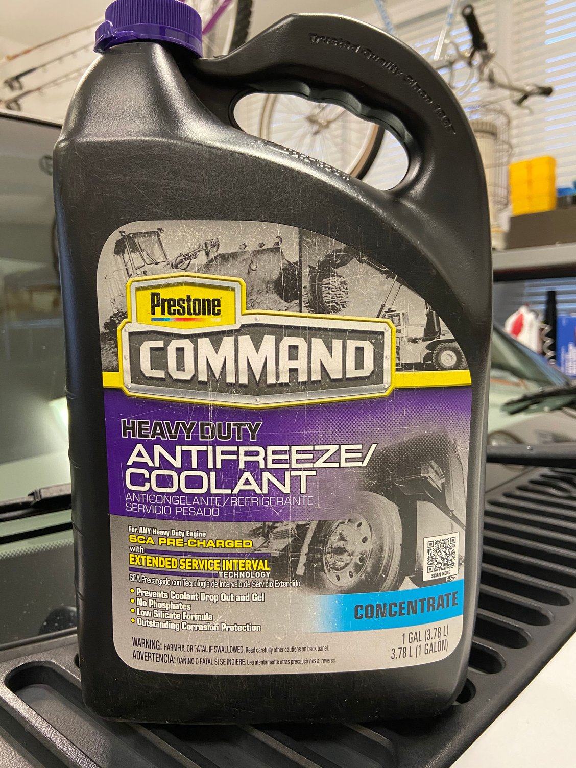

Anyone see a problem with this product in an early 99?

Provided you do a full flush no I don't see an issue. We use the purple coolant on older equipment where ELC can causes issues. For your use the SCA charge will never need to be topped off but should be checked every 50k.
