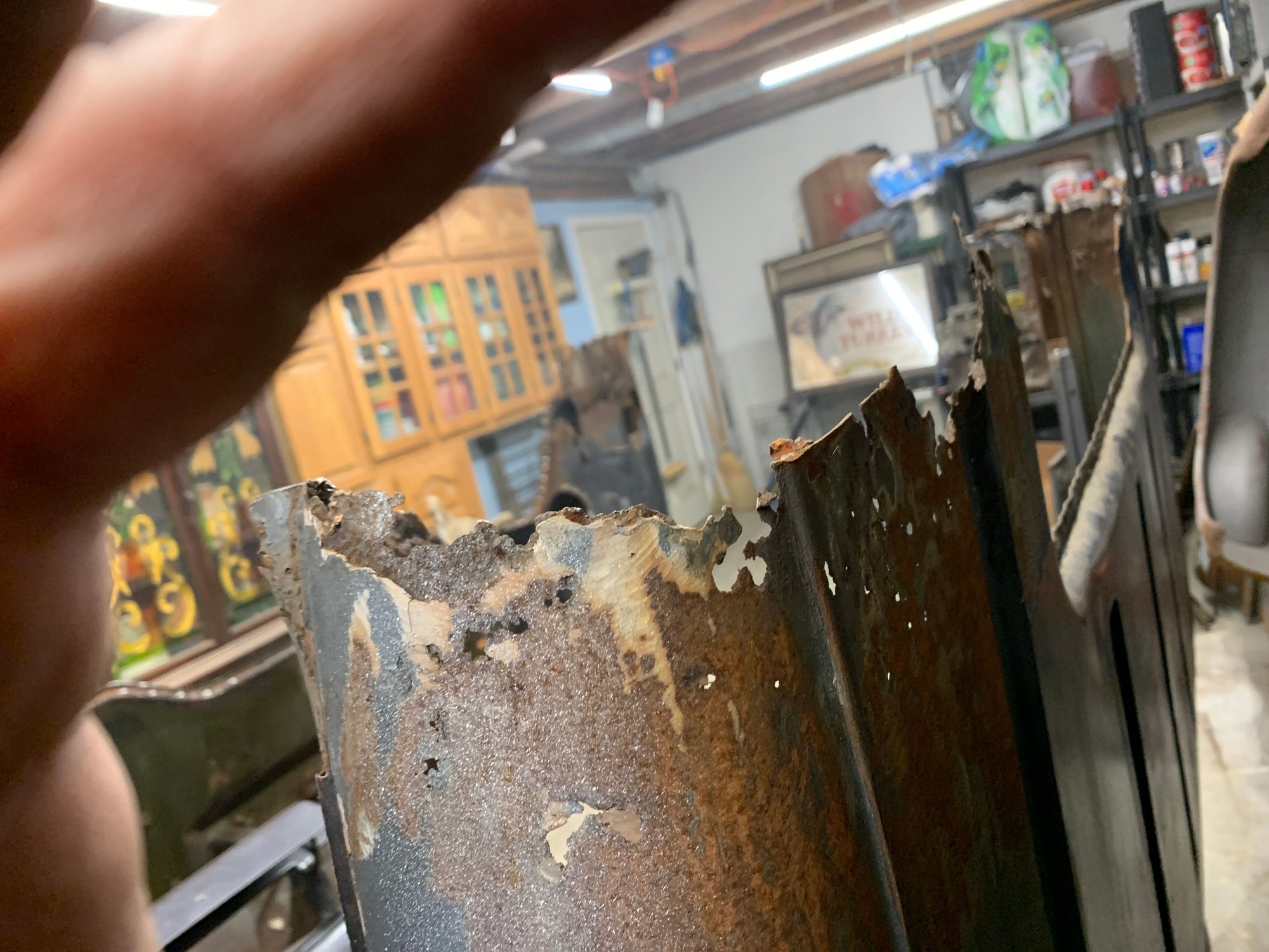

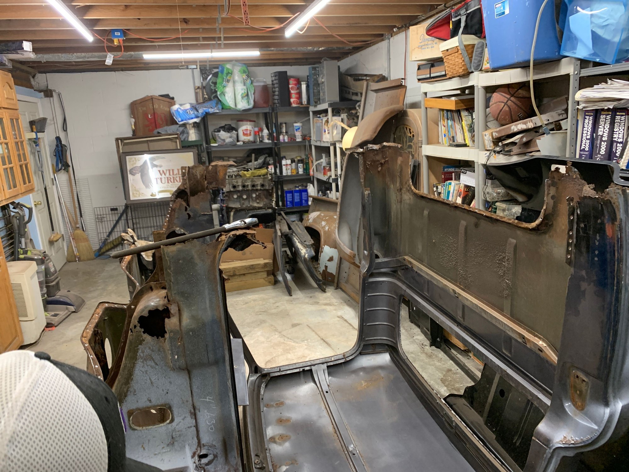

I have my floor completely removed and need some help on if I should replace the cab corners first or the floor.
if cab corners go in first how do I ensure they are at the proper location?

I am not a body guy. I have watched lots of videos and TV shows. Maybe it's just me but the astronomical probability of twist is high right now. Before the floor was cut out there should have been cross bracing welded in to prevent twist.

It does not matter now......BUT you will need accurate measurements from an unmolested cab to repair yours. At this point it may be more efficient to part out your cab as repair panels and look for a replacement cab. Good cabs are out there, but expensive - around a grand in the humid rust prone environs I inhabit - maybe better in your local. It is going to be very difficult to get that cab to align correctly, but you may be very talented and have no problem - I’m quite sure I would have a negligible chance of getting everything to align correctly.

I'd say that puzzling it together would be a better fit since you could use your door shells to locate your rockers then your inner rockers, mid-cab floor brace, floor pans and so on. Personally, I'd worry about the outer cab corners until later. Get all the above situated first along with the inner cab corner then finish the outer. Good luck and keep posting your progress!

Not sure what you have that was removed but your photo shows you need the floor, front cab mounts, center cab support, rear support, lower a pillars, lower b pillar, sills, cab corners. If you are actually going to fix this cab I'd start with getting the sills installed making sure your door gaps are good all around. Then the floor. Then the cab mounts and center and rear supports making sure all of the cab mounts line up with the frame. Cab corners would be last. I would also only tack things in place until everything is back together, doors on, sitting on the frame to verify everything is where it needs to be. Good luck and post lots of pictures.
