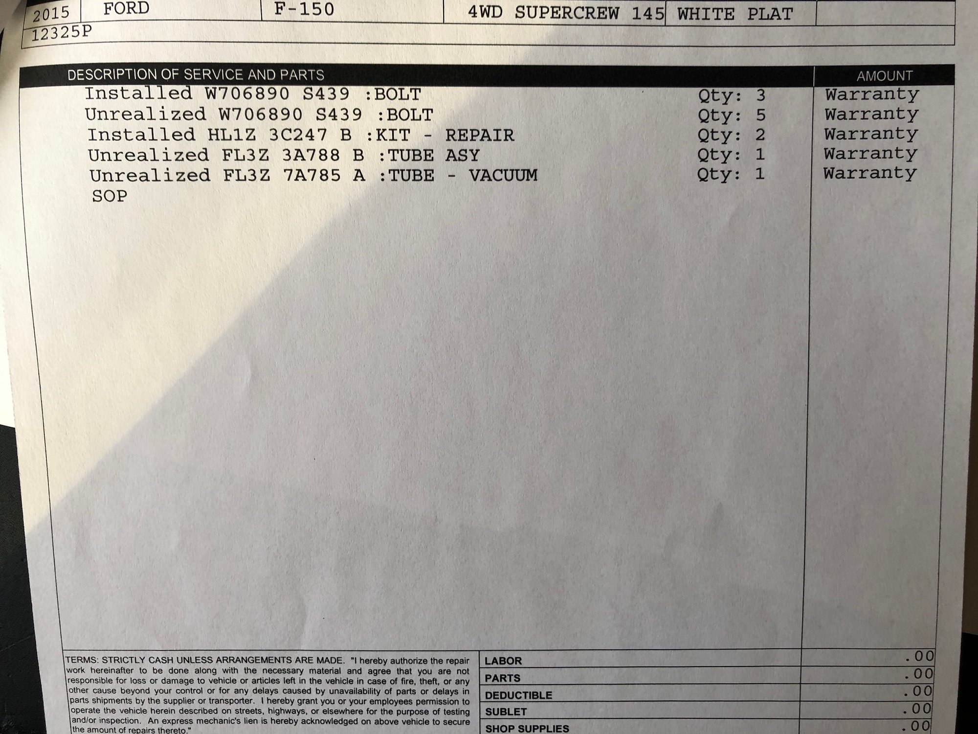

Purchased a used 2015 15 Lariat Screw 3.5l in early January 2020 and basically the next cold morning started hearing these IWE noises. Thanks to this forum I isolated the issue and found the TSB. Took a good month before all the parts were in but here are the details of what they replaced under "warranty".

LOL, looks like they didn't want you coming back, they about replaced the whole system.

I think we can thank the TSB for that. The noise was getting really really bad by the time I got the call. I can only imagine what untold damage occurred.
Thank you ford-trucks.com for the empowerment.
