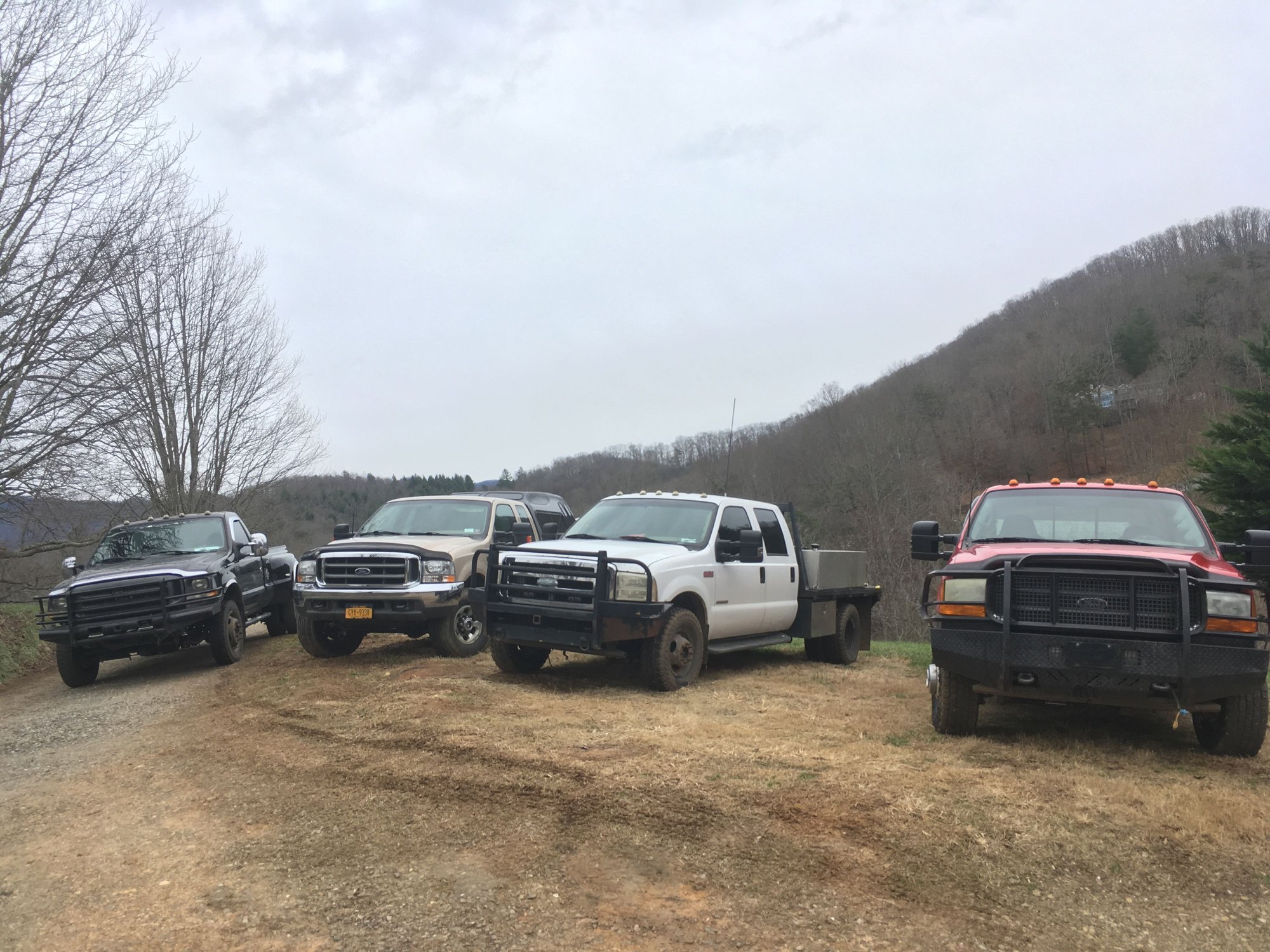

‘01 F350 cab chassis 6spd (my dually). 460k miles on it now.
Wipers will only come on in ‘high speed’ and will not turn off in any switch position. When the key is cycled and wiper switch in any position but ‘high/fast’, the wipers will park like they should. The ‘wash’ button works and when activated, the wipers and wash pump function like normal. (Spray and a few swipes)
No stored codes.
I have changed the multi-function switch and the wiper motor and no change at all.
GEM problem??? Is it possible to re-flash it with IDS or something else??
White truck is the offender.
Any advice would be appreciated!!
