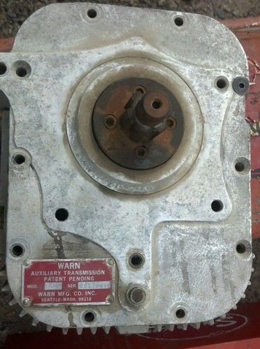

In my buddy's truck he has run a Warn overdrive for years. The shift lever closest to the seats. It uses a ravigneaux gearset. The oiler is from a Briggs and Stratton lawnmower engine.
That particular one bolts to the back of an NP435 after removing the output flange housing.
But, they are very rare so probably not a viable choice.
