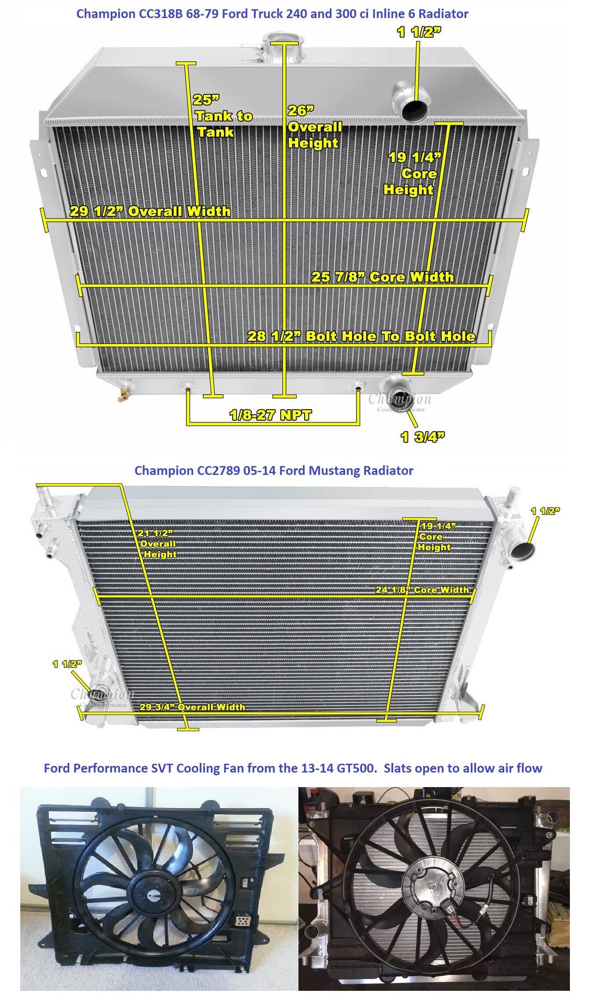

This will require some "plastic surgery" but I think it's going to work. I prefer OE fan options. I'll keep ya posted on my results.
I'm going to pull the fan from my 2012 GT and see if this will fit. I think I could just trim the mounting tabs and other junk hanging on it and secure it with some aluminum angle on the sides. Dimensions are very close. I haven't seen anybody do this yet.

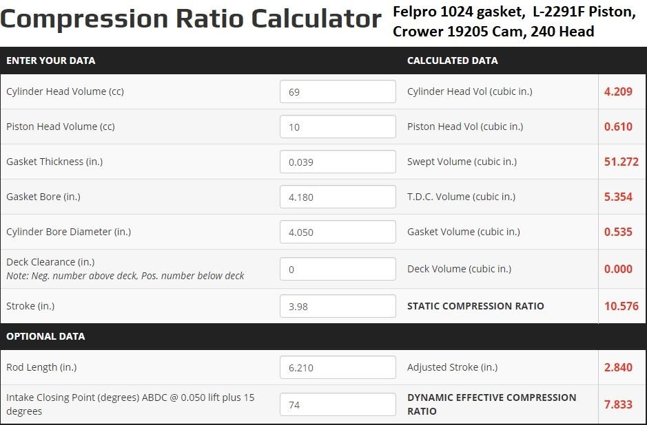

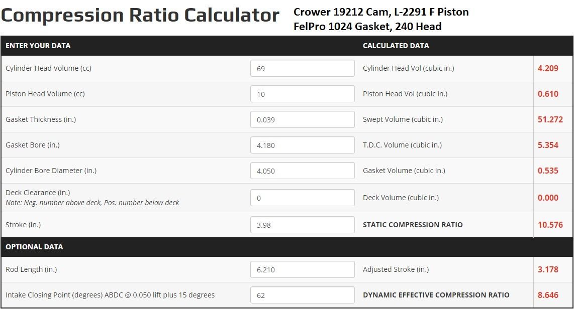

Dynamic Compression
My elevation is at sea level. What's up with the vendors and their cam recommendations?
I've been playing with the calculators. LMK if you agree with this.
Intake closing point is calculated without subtracting anything for ground in timing. The Crower cam is at 0 degrees of timing and the stock cam has -4 degrees built in from the factory as I understand it.
Intake closing point Crower 19212: (260/2)+112-180=62
Intake closing point Crower 19205: (284/2)+112-180=74
I've also used an arbitrary number of 69cc for the cylinder head volume. This may be higher if I have room to unshroud the valves once I bore the block. I will be measuring this.

Here's the numbers I have with the 19212 cam
Here's the numbers with the 19205 cam
Keep in mind i'm keeping this NA. I love the idea of boost but would be detracting from the simplicity of the vehicle and will be overbuilding it for what I intend to use it for.

I don't know of anyone that has used the Flatout head gasket.
This persons lives in Kansas at 1100 ft elevation.
He is running the Schneider 140H cam. (.496”/.496” 222/222 280/280 110deg) and a 9.75 static compression ratio.
Originally Posted by BigBlue94
My cam puts the DCR at 7.47. It will run on 89, but likes 91 better. No knock sensor, it's as bare bones as possible
I would say that you would be fine with 93 octane with a 7.7 DCR.
What happens is as you push the DCR limits you need to back off on the timing and you lose power.
It is better to give yourself lots of margin which keeps both ignition timing and air/fuel ratios from being critical.
