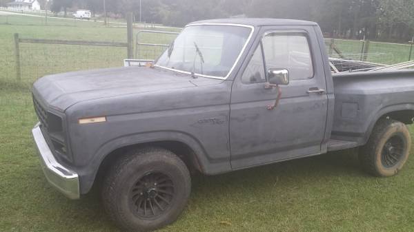

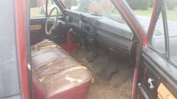

I will be 60 come April and not as fast as I use to be also LOL
Yea my project started to get the truck road ready just to take trash to the dump weekly and got out of hand and turned into a 4 year cab off frame rebuild.
CL ad before I bought it
After
Some seeing the pictures might get a kick needed to start on their projects.

Wow you did a lot of work on that one, it looks great, if mine turns out well I will probably fix the minor dents and paint it also as the original paint is from "83" and so it's not real pretty any longer.
Still raining here so I just stay in the house a lot,(Iv'e had the same warden for over 52 yrs and she doesn't let me out much when its cold).
Great pics of the old truck, you made it look new again!
