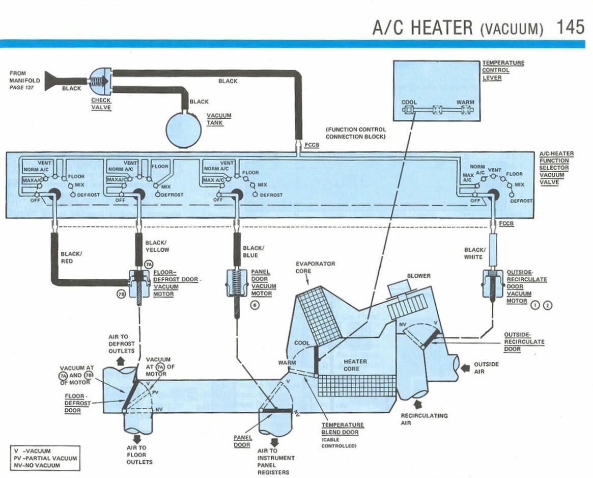

Hello Im new here and no real sure
Im doing this right so here goes I have a 1984 f150 302 auto 2 wd. I bought it with the motor bad. I put a reman 302 back in it and the first time I drove it Squirles had built a nest in the fender well and it caught on fire. It burnt the heater box, heater fan, and melted the wiring. I got a box and fan assembly from a 1983 f150 the problem id that some of the wire colors are different. some of the connecters burnt also.
So I need a simple diagram on how a 1984 ac/heater is wired up I need from under the dash out to where ever they go. I hate to ask for help on my first message but im lost
