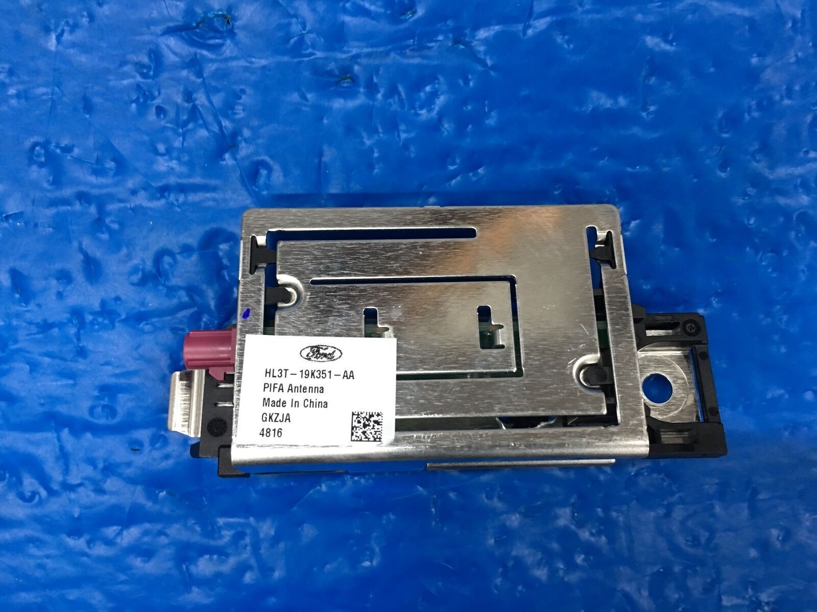

The 2 Ford OEM antennas don't have a ground wire, they just bolt to the truck body which grounds them (even though it is aluminum).
Here's a pic (from ebay) that shows the mounting hole for the bolt on the PIFA antenna that connects to the TCU. HL3T-19K351-AA is Ford's engineering #. The part # if you wanted to order it is HL3Z-19A390-A. The shark fin antenna on the roof of the truck is also grounded when it's bolted to the roof.
Hope this helps
Andrew
2019 F350 XL (STX) SRW 4X4 CC SB Super Duty
6.7L Power Stroke Diesel
Oxford White
I wonder if I could just get two of those PIFA antennas. One for the TCU Sync Fordpass antenna port, and one for the wifi hotspot antenna port and mount them both to the back wall with M6 clips and bolts? This should correct the "ground" DTC. It may not be an ideal location for the wifi hotspot antenna to get optimal signal strength but that isn't a huge issue. Especially since I can't seem to active the hotspot portion of the TCU just yet. I do understand that I would need to have separation between the two antennas. I'd also need the factory cables for them. I think I'm going to try this and see what the result is. ---- Or is the PIFA antenna specifically designed for only the TCU and won't work for the hotspot?
Yep. It's been done.
https://www.f150forum.com/f118/sync-...1/#post6467078
Hope this helps
