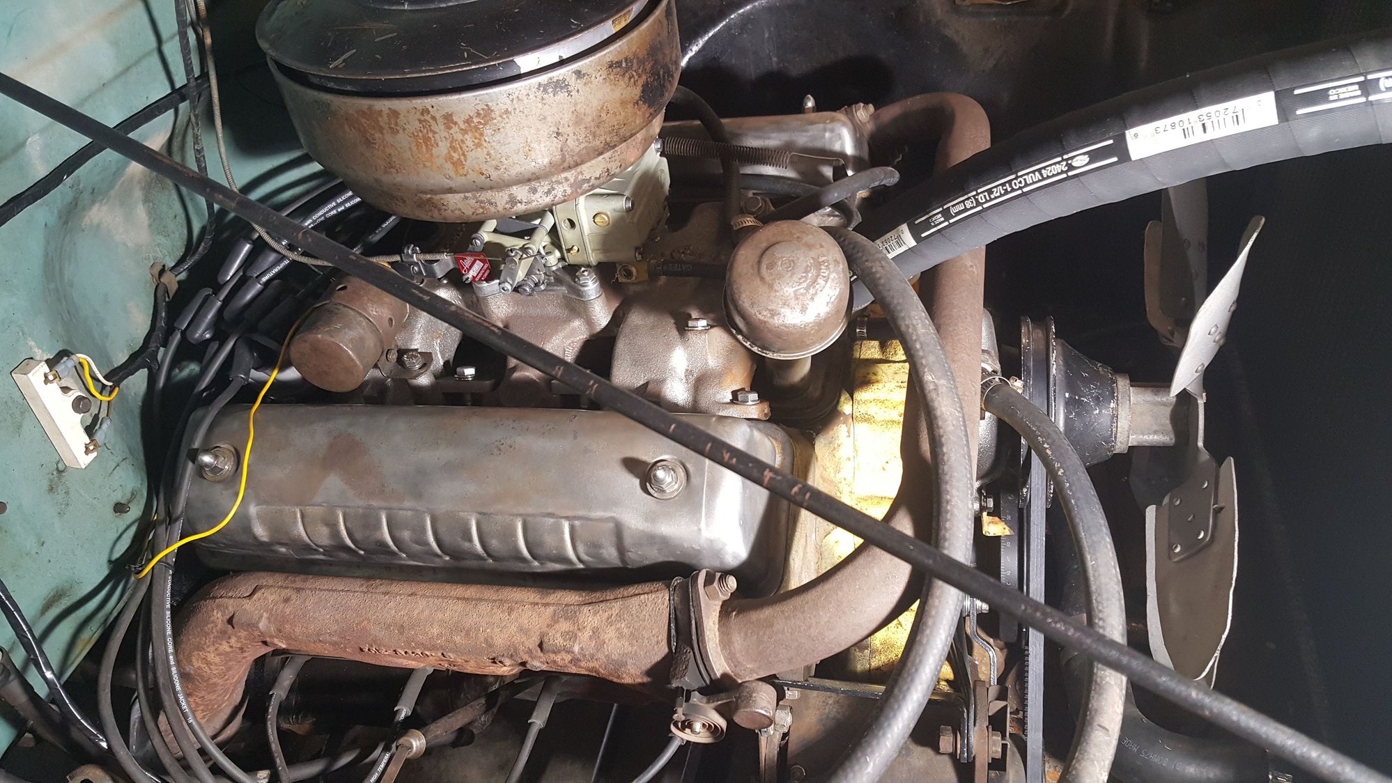

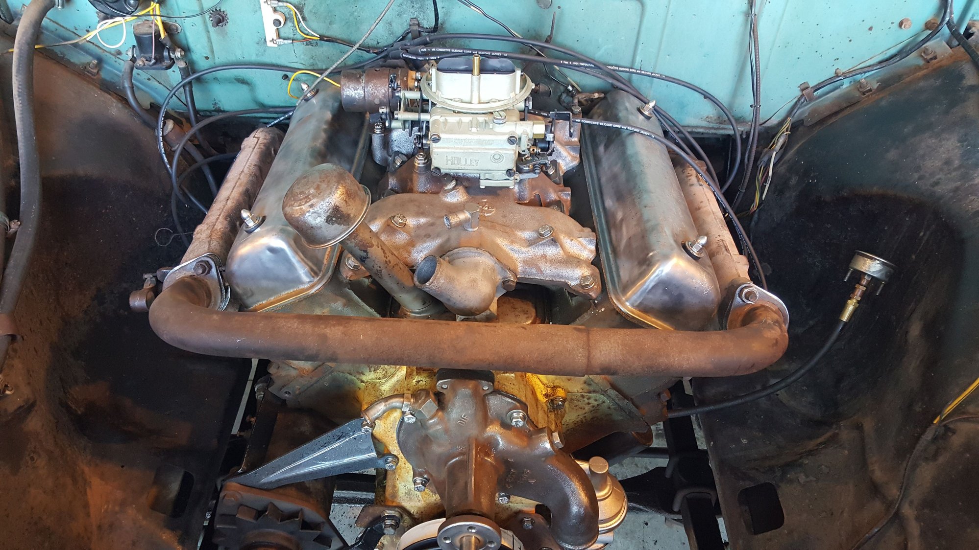

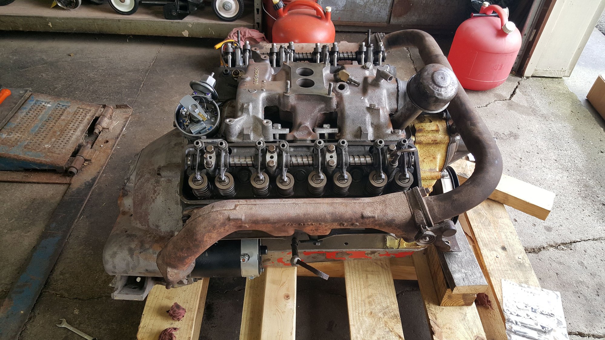

So it's been awhile since I've updated my engine swap. The '55 - 223 is now a rebuilt '58 -
Rebuild stage
Freshly installed
Runs like a top
292. It runs great and is a whole lot more fun to drive! Many thanks to this forum for various tips that helped me with the change over. I'm including a couple of pics. This coming May, I'm changing out the 3.9 stock Dana rear end for a Ford 9" with highway gears. So my question is about brakes. I'm opting to stay with drums since this is a stock engine. Does anyone know the best option for adding a power booster? I'm looking for a bolt on to the master cylinder without having to relocate it to the firewall. Does this exist or do I even need it with the drums? Thank you!
