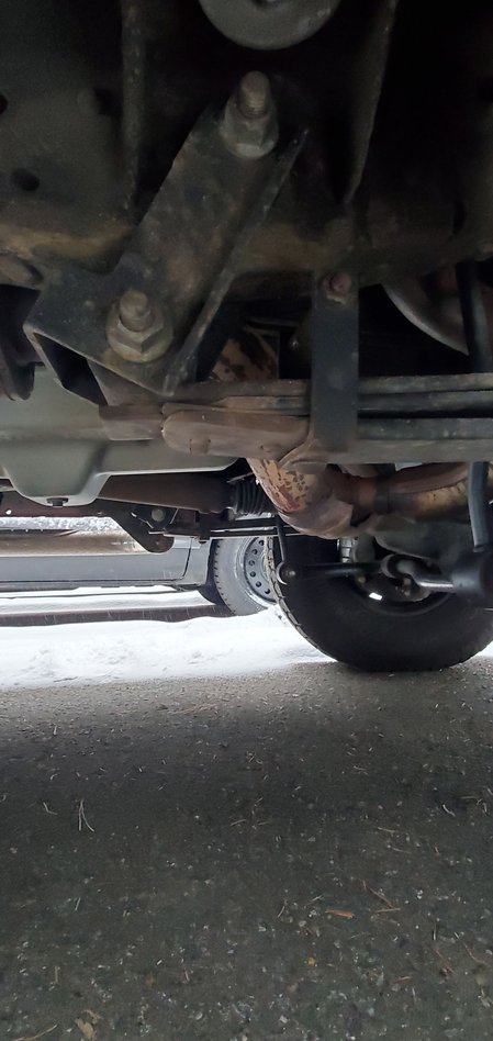

Trying to ID my front springs. 2004 F350 CCLB. I've been reading about the X-code springs, but the pics don't match what I have. I seem to have a healthy size add-a-leave up front. Truck sits almost level. 285//75/16s easily clear. Bought it this way and always thought it was a factory setup, but maybe not?
a leaf for a bottom spring.

You have V code front springs with an add a leaf. As far as what rides or works best I can’t help there but you have a fair amount of room.

All the 99-04s have 2 leaves up front. V's are pretty whimpy.

AFAIK V code springs were standard on Super Duty's. The X codes were an upgrade for plow package and camper package trucks.
I have seen another truck with three springs like the OP's.

Actually the base front spring was (I forget the letter) 4,400lb spring THATS WHIMPY! The V code was standard on the 7.3 trucks and was optioned on other trucks. Then u had the W code and the big daddy X code spring. I had the add-a-leaf on my 04 and HATED IT was gonna go with X codes because of all the information in the Excursion section and from people here, BUT I wanted slightly more so I went with pro comp 22210 2.5" level springs. I couldn't be happier now, ride is really really good and my height has held for years now with no sag other than initial settlement

I bet someone switched to a F450/F550 spring. Add a leaf springs aren’t usually that long. I’ve never seen F250/350 with three spring pack or a overload that’s that long.
I put a set of X codes from Deaver springs. Ride was a lot better

F-450/550 also only had 2 leaves, even the heavy W codes and heavier yet X codes. Remember that the actual letter designations are for Ford springs only, aftermarket springs advertised as the various letter codes are usually only close to the factory ratings, not typically equal to them.

I put Deaver X codes (rated) and they not only made the ride better they also lifted the truck up. These were 2 leaf type. I've seen F450/550 with three leaves. These were commercial type vehicles on jobsites. The leaves on those trucks looked factory not aftermarket add on type. Maybe they were add on springs but usually add on springs are shorter.
I ordered a set of X codes from Sd springs and I didn’t care for them. In the center where the locating pin and u bolts would sit the springs narrowed down in that section which I didn’t care for and the guy from Deaver springs really saw as strange. Deaver Springs is a well known spring manufacturer. The cost difference was minimal between the two springs so I went with the Deaver version and sold the SD spring X codes.
