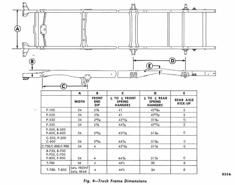

The frames on these trucks are simple and built to handle a lot of flex in the suspension. If you are new to the early F100 hobby then you would probably be best served by finding a replacement OEM frame. If you have fabrication skills then you could build one (as it appears the previous owner of your truck did) to suit your requirements. Here is a drawing that you may find helpful with whatever path you choose.

I agree with Charlie. Frame fabrication takes some skills and a frame jig is highly recommended.. It ain't just about dimensions but at least you could check your frames dimensions against the stock drawing Charlie posted. Gud luck and welcome to FTE

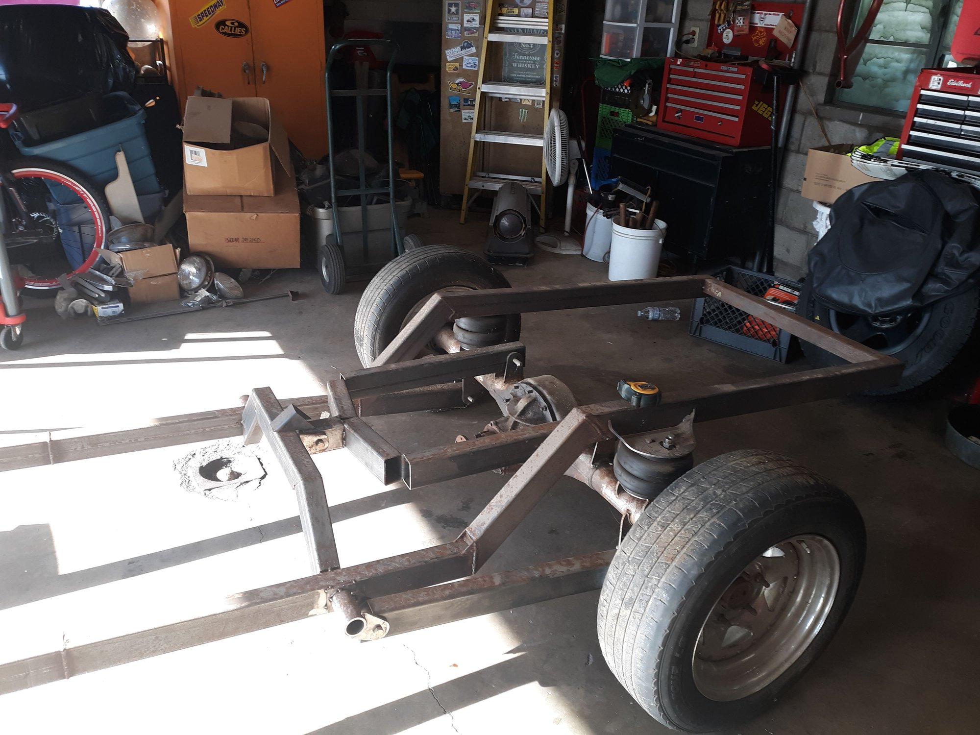

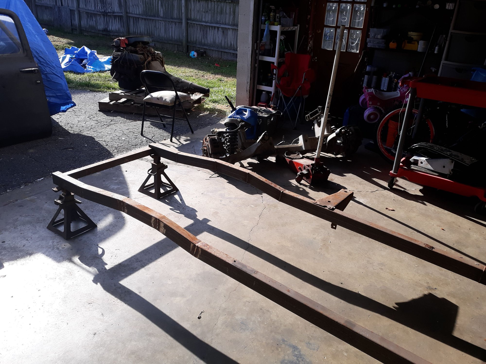

It is your bear bone frame that's why I wanted to know if anything else would work with little mods just something I can work with. Now that me and my son started taking measurements we are finding out nothing is the same....go figure

Well now! There’s not much there is there? I’d give it an E for effort but not much more until all the measurements show it’s square.
I’d say looking for a rolling original frame may put you way ahead in your build if you’re planning to just enjoy your new ride. You’ll find that acquiring all the stuff to put one of these together can be daunting enough let alone having to engineer stuff to fit a non original frame.

That homemade frame scares me. I wouldn't trust it.

Yeow! Time to wipe the slate clean and start over. Rectangular tubing should be a minimum 2x5 0.120 wall. Lots of 4-links on the market today, no need to cobble up a mess like that. Best bet is to get a good OEM frame and go from there.

No way I'd use what you have. Find someone with a parts truck and buy the frame off the guy..

that is mailbox post material... find a frame !

I was thinking workbench..
