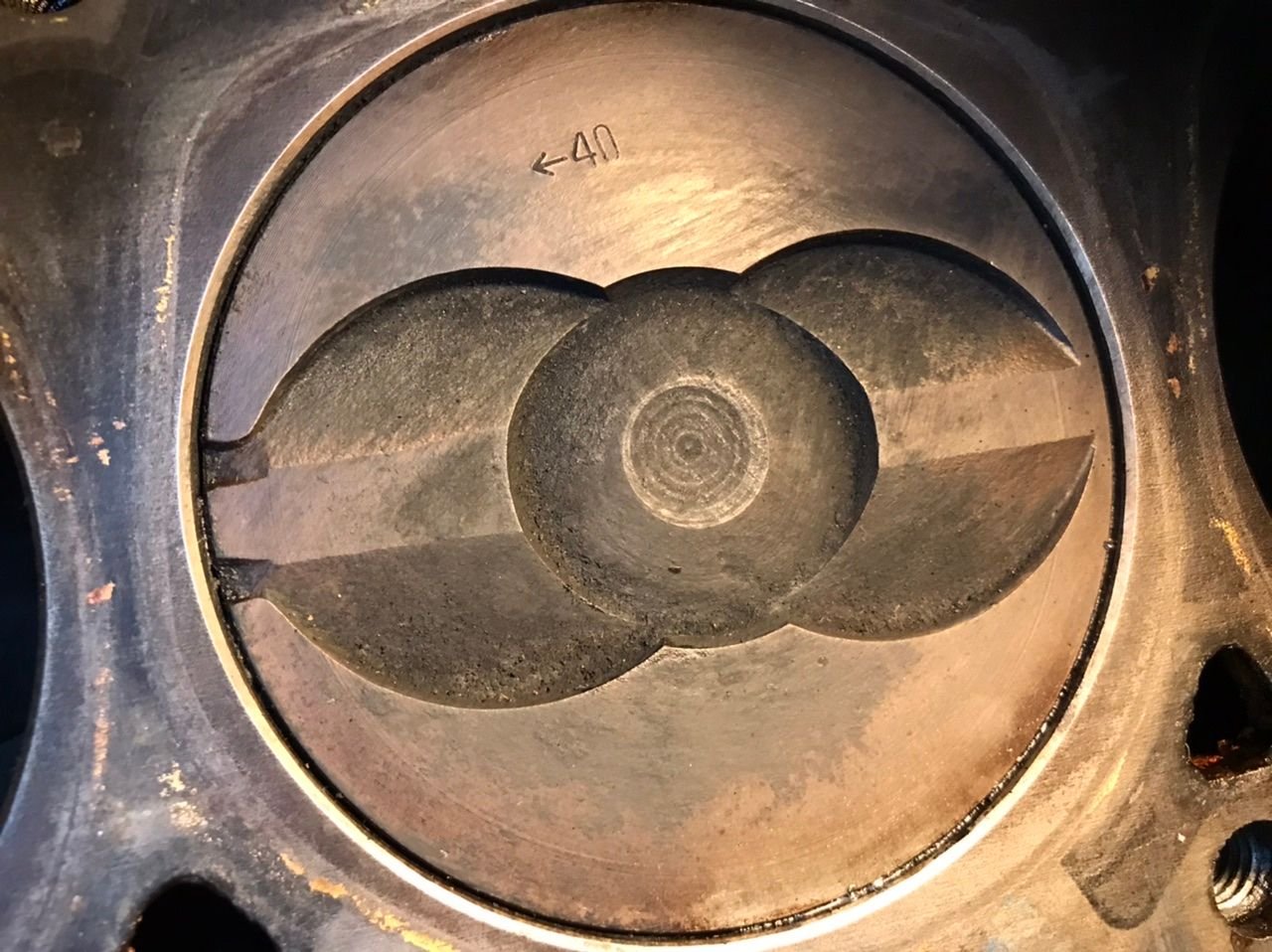

Yes I bought one recently and it's a combined volume type.
I was replacing the lifters since the truck sat for 15yrs.
Might as well in case oil crud buildup etc.
But the new Summit lifters have a different cup.
So, I guess I'll take the old lifters apart.
-But, I did find out someone has been in this motor. (.040 pistons and taking the valve cover off, the heads were very clean).
-So as you see in the pics, the lifters (old ones), are pretty good looking etc.
-Second owner from a elderly man who passed and his son let it sit under a tree for 15yrs.
